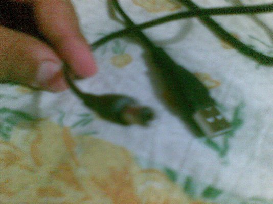

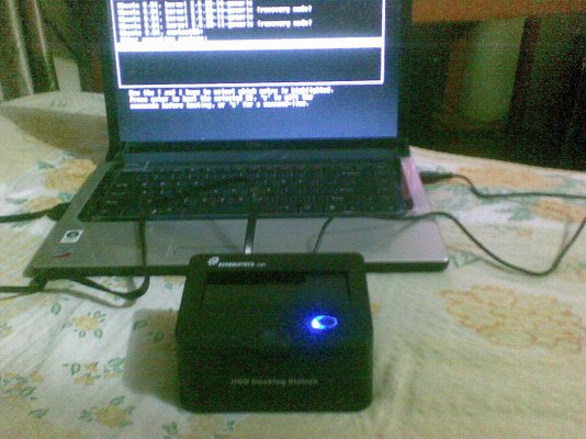

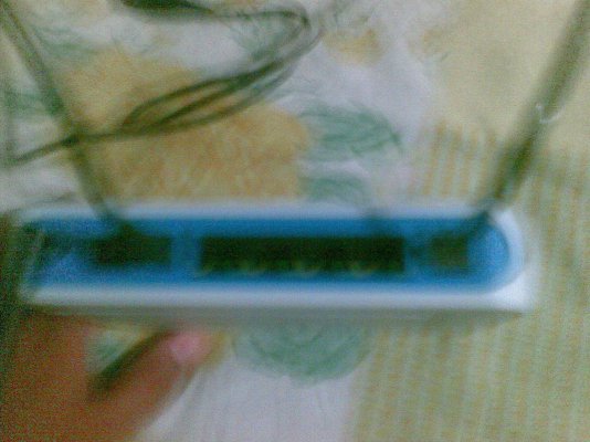

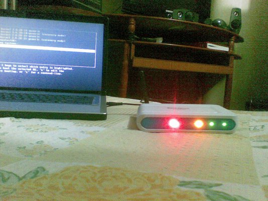

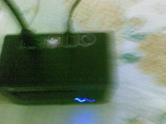

Alright here are the pics with the modem running.Sorry for the low quality of the pics as they were taken thru my phone's camera. Lemme tell u all about it.
The cable being used is a USB to DC power cable that came with a USB DVD Writer I bought along Lenovo S10 for my sister. She left without taking the DVD writer so on one mischievous night I used the cable to power up my Type 1 modem. Since I had my Type 2 modem also, it wasn't a calculated risk but more of a calculated n00bish nincompoopery. :rofl:Well the modem worked all OK so I hooked it up to my WiFi modem too. It also worked and since then it has been a indispensable cable in my Laptop arsenal.
Besides small devices like modem, it is also capable of running HDD docks like the Sunbeam one which I have. Since the cable was not available at my city as a spare, I'll try to get it from Amarbir, tomorrow if he has any otherwise I have discussed with my Electronics repair guy and he is willing to emulate it if I can get him the parts and the schematics, u know the pin config for USB etc.

lol :bleh: me no Champ, just a lucky noob.
The cable came with a external slim DVD Writer which I bought for my sister's Netbook. It is able to power various devices that use that 12V DC port but power ratings do play a major role. The cable can provide only that much amount of power, which is practically possible from a USB port, anything over 5V DC, well better use an adapter.
I did gave my local electrician a USB cable and the DC pin but emulation was not successful so as they say, Gotta get something done, do it yourself.
I'll try to make the cable myself and if succeed in it, I just might take bulk orders. ;)

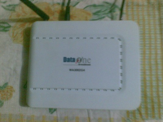

Samkong said:
Yes it is possible as the modem needs only +5V volt, even if we are connecting a 9V or 12V adapter, inside there is a 5V +ve regulator "LM7805" so power requirement is only +ve 5 Volt, but for stability higher voltage is given and regulated so that if there is any voltage variation on the the main line, the modem will always get +ve 5V. Since from the Laptop(or Desktop) USB it is always regulated, It works more than fine.
You are right man. I was able to successfully make a USB power cable for my Modem:clap:. As I use Auto power on and shut down for my PC for the downloads between 2 to 8, I was looking for this. My experiment went successful:hap2:, I powered UTSTARCOM WA3002G4 through USB port of my Desktop PC, which I use fr downloading the movies using BSNL's Night unlimited plan. Any one looking for any help PM me, will be glad to share my experience.:hap2:
