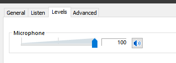

The only sound control I have is the mic level.
