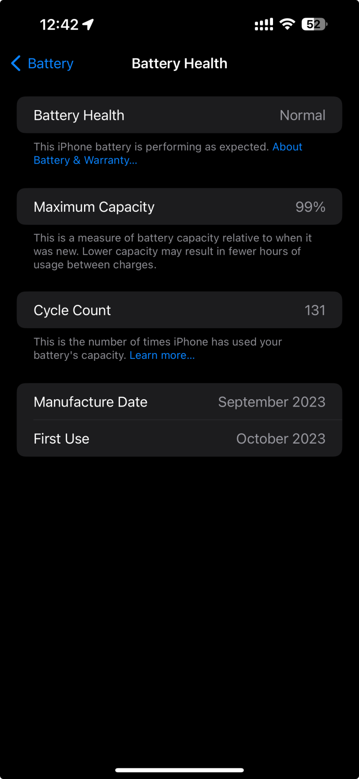

For 450, there is an average of 10% degradation in 5 years. Li Ion in my iPhone is at 99% after half a year and I charge the phone once a day atleast and generates lot more heat. By your logic is this a lie? When battery in phone that is charged using a wireless charger day in day out (generates lot of heat) and is used every minute of every day is at 99% after six months. I do not see why battery on scooter cannot be at 99% after two years.

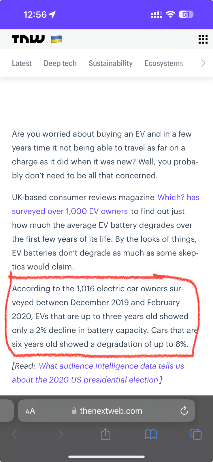

You may also want to see this report
its not that whether its a lie or not .But in india whether do we have an independent way or standardized way to validate the claims.

This is a good point. So I looked it up and found this.
Basically, iphone batteries do decline as expected over time. But the maximum capacity will seem stuck at 99% because Apple only considers the loss from the rated capacity of the battery. The actual capacity of the battery varies and is usually significantly higher, giving you a bit of a buffer at first. Eventually though, it will start falling. But the point is this, you're still losing capacity whether that number says 99 or 100. It is just not getting reported.
I suppose Aether could be doing something similar. In that case, you should soon start to notice the percentage drop as the capacity falls below the rated value. Here again, the important thing is this, you're not cheating the laws of physics. You're still losing battery capacity at the expected rate. Your EV cannot go the same distance on a single charge as it could when you bought it.
To me, that's a problem. I also don't really buy the 10% in 5 years number you just quoted, because that would make Ather's li-ion battery more durable than a Tesla.
I saw this behavior on iPhones, but never knew why, this makes sense.

Not going to side track into iPhone battery. Tesla is way above Ather. Tesla battery has average of 10% degradation after 125000 miles. It takes 50,000 miles to lose 5%. They are already moving towards battery that retains 80% after a million miles. I think they now are at 12% degradation after 2L miles. This is incredible.
Coming back to Ather, 10% in 3 years is still below the benchmark set by Tesla. In EV 2wheelers in India, Ather has been leading the battery space and now Ola seems to be giving 8 year warranty on battery. My in laws recently purchased Innova Hycross hybrid and the battery has 8 year or 1.6L kilometer warranty.
I have first hand experience of having no range loss in 2.5 years, have first gen owners vouching that their battery is still solid. This owner did real world range test on 450 after riding it for 70,000 kms. Take a look.
I hope this sheds fear of battery degradation. In case one is are still afraid or is not ready to believe that EV battery outlives the vehicle life for normal user, it’s okay to live in denial.
