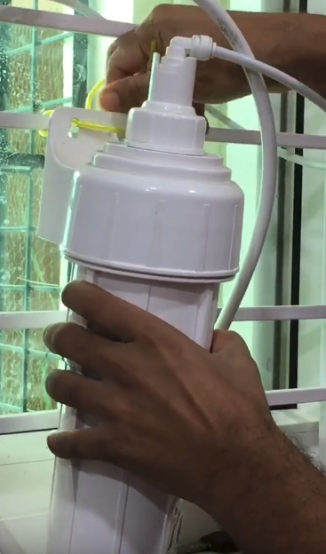

So finally after 23 months the Indicator showed up
@blr_p
Do I need to replace inside of only this?
Update... got the filters changed few weeks and only then the technician says the led shall blink red for a replacement and the green led is simply normal. This is ow they loot their customers.
Anyways, he was shocked to see that been 2 yrs yet no red led indicator.
He also advised to keep changing the sediment filter every 6 months
