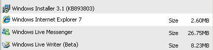

- Click Start, and then click Control Panel.
- Click Add or Remove Programs.
- Scroll down to Windows Internet Explorer 7, click it, and then click Change/Remove

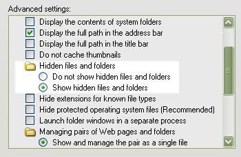

If you cannot find Internet Explorer 7 in Add or Remove Programs, click Start, click Run, type %windir%\ie7\spuninst\spuninst.exe, and then press ENTER.
Note: %windir% is the location of your Windows directory, which can usually be found at C:\Windows. To do this, you need to have "view hidden folders" enabled.

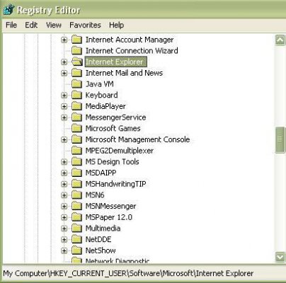

Internet Explorer 7 Fails to Uninstall from Specified User Account
If you see an error message saying that you cannot uninstall Internet Explorer 7 from this user account, you can bypass the check by following these steps:
- Click Start, click Run, type regedit, and then press ENTER.
- Navigate to HKEY_CURRENT_USER\Software\Microsoft\Internet Explorer.

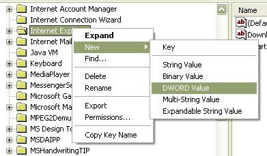

- Right-click the Internet Explorer key, click New, and then click DWORD value.
- Type InstalledByUser as the name, and then press ENTER to finish creating the new registry value.
Try to uninstall Internet Explorer 7 again
