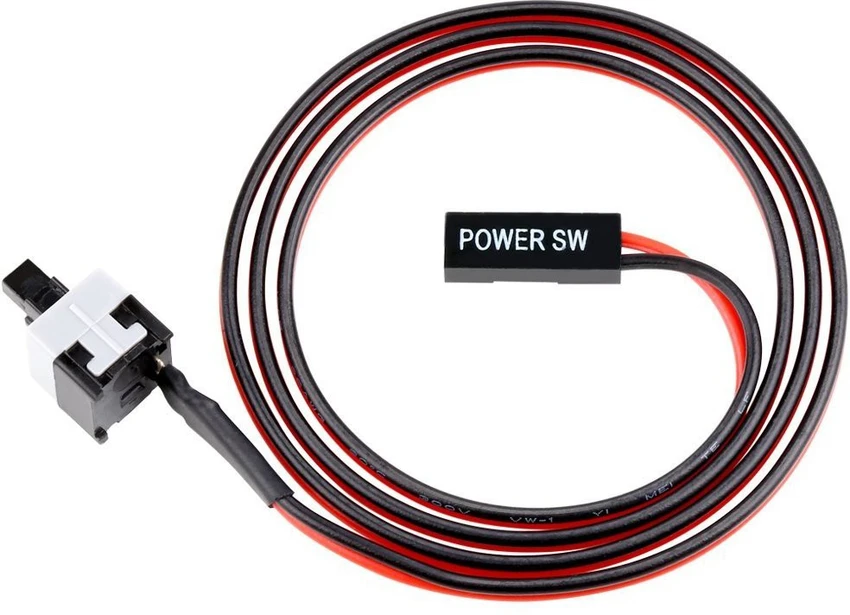

OC & Modding Is it possible to repair or replace the power button of a PC cabinet?
Maybe I asking the wrong question, but how do I know that this will fit or be compatible with the existing power button? Or is this a universal one size fits all kind of thing?
Afaik on any fancy external button this is what its which fits internally! Unless your case front header comes with its own hub where such switches are soldered to the hub pcb.
You need to show here the button for getting a better suggestion.

So, a creepy and bizarre twist in the tale happened to finally end the "faulty power button" episode today. Just a few minutes back the side panel glass burst into a hundred pieces in my hands as I took it off to look inside the PC. The power button started working fine since this morning and is back to working normally but I am left with a completely open side panel exposed to dust and all other elements. So, in the end, I will have to go for a new cabinet pretty soon, I suppose. The very thing that I was trying to avoid. :( The external button from Amazon had also arrived but it is going back now as there is no need.
P.S. After the comments here, I checked and the power button of the cabinet had the wires soldered on. So, internal replacement of the switch was out of question.
