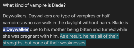

With wireless charging, you are getting all the adverse effects of fast charging, minus the fast charging.
(I call it a reverse-Blade situation).
Use a slow charger. 5V2A. Or QC 3.0 (18W) for balanced speed and longevity.
Fast charging degrades battery because of the heat it produces.
