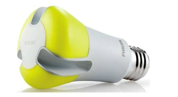

i am eagerly wating for philips to launch this led bulb in india..
It look so nice in picture and has great review to but it will be costly..
