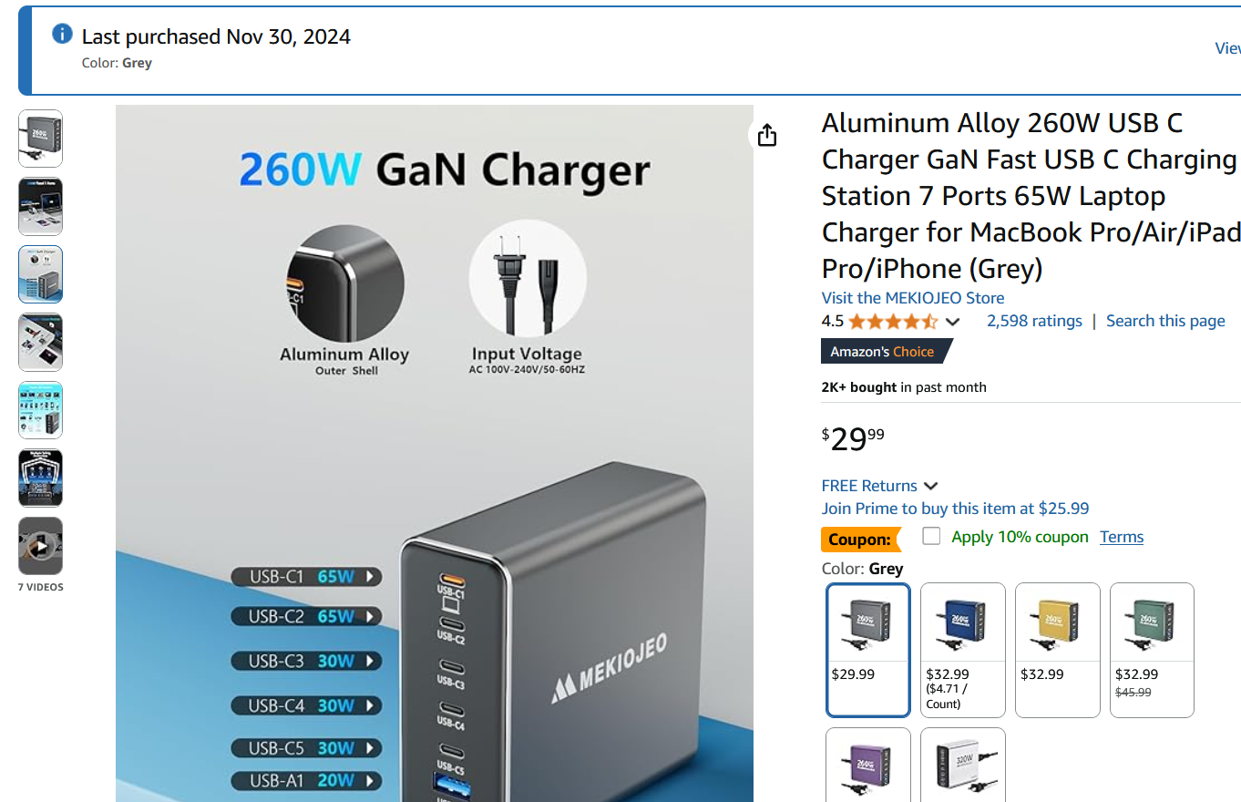

Use Amnols service and get this - https://www.amazon.com/dp/B0BGLTD816
I got it for $33 , not its $27 . Well worth it , good reviews on SD and all ports have seperate power delivery . Whenever i connect any new device the already connected device does not reconnect
Any leads to anmols service? I read the talk about it on the cheap openwrt router thread but didn't see the link for his service (or I missed it)
