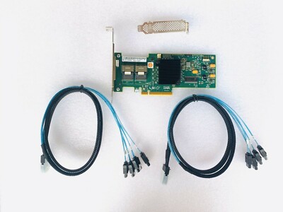

If you're planning to use ZFS, avoid those SATA cards. Instead, opt for an LSI card that has been flashed to IT mode.

So far so good. I bought a used one from a member here like I said, and it was way cheaper than a new one so I took the risk. Besides, there is not really much of an option; it's either the LSI with software raid (IT Mode) or the PCIe to SATA. There is also this NVME to SATA converter, but I haven't used it, so you have 3 options basically.

For the SATA expansion, I am using an LSI-9211-8i that I got from ebay from a Chinese seller for around 3k (including the SAS to SATA cables). Was already flashed to IT mode by the seller, plug and play with TrueNAS Scale (proxmox VM with pci passthrough of the HBA). Some online reading suggested to add small fan on this for proper cooling as they’re meant to run in servers with good amount of airflow, so cable tied a 40mm fan on it.
One downside of running these LSI SAS2008 chipset cards is that they are old and don’t support modern PCIe power management features, so they add around 10-15 W to the power even at idle. If you’re concerned about that, look at ASM1166 based sata cards, like this: https://amzn.in/d/ehgudKx. Have not used this, so YMMV.
