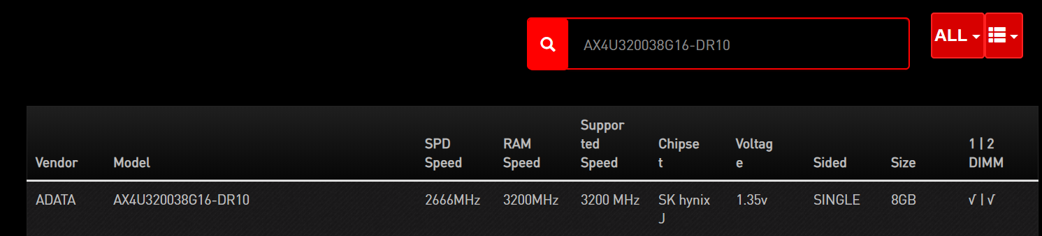

Selecting RAM for Ryzen is a bit of a pain but I checked this RAM kit against MSI's compatibility list and its supported.

I selected AData to stay within the budget constraint as well as compatibility. Personally I use G-Skill RAM.
Try to go for at least 3200+ MHz RAM as the performance of the in-built graphics of the 3400G goes up with RAM frequency.
