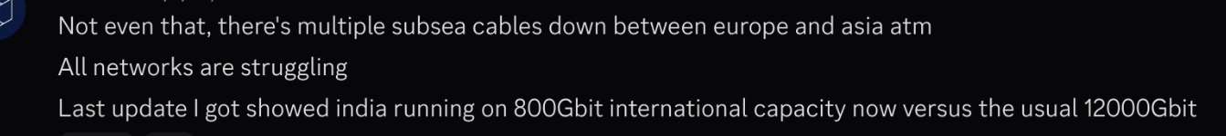

One reason could be the several cables in Red Sea were cut, and in general they've lost quite a bit a capacity to Europe. I have seen marked increase in pings and decrease in speeds to Europe in the last couple of years. One more complication is some Tier-1s not interchanging traffic with others in Asia. Examples being TATA-Cogent-HE-NTT. A lot of this information is kinda hard to get, and is not usually advertised.

Maybe a typo, this was in march 2025. Heard that we lost at least 25% capacity. combine that with depeering issues, My excitel traffic goes to HK for singapore server, europe pings have increased from 135ms to 200+ depending on network. Most VPN servers use cogent/HE backbone coz they are cheap. Best way to find out what is causing the issue is to check a trace route to the vpn server you are connecting to, find out who's at fault, or pick a server which has better peering and lower load.
