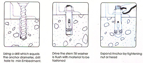

op needs "ceiling bolt anchor"
actually, i had bought an universal projector ceiling mount,
the mount don't have screws for mounting projector, and in the projector manual the following specification is being given for mounting it on universal mount :(.
The Pic provided by @booo, i am already having that screw, and it will be used to fix the mount in the ceiling
