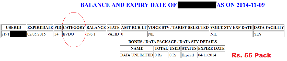

Furthermore, I have attached my number details from bsnl cdma prepaid query. It shows my number under EVDO category. Even I got that Rs. 399 balance which is only received when number is activated under evdo category. I paid Rs. 40 for the sim and didn't purchase modem from them. Rs. 55 STV also got processed. But EVDO not connecting.
