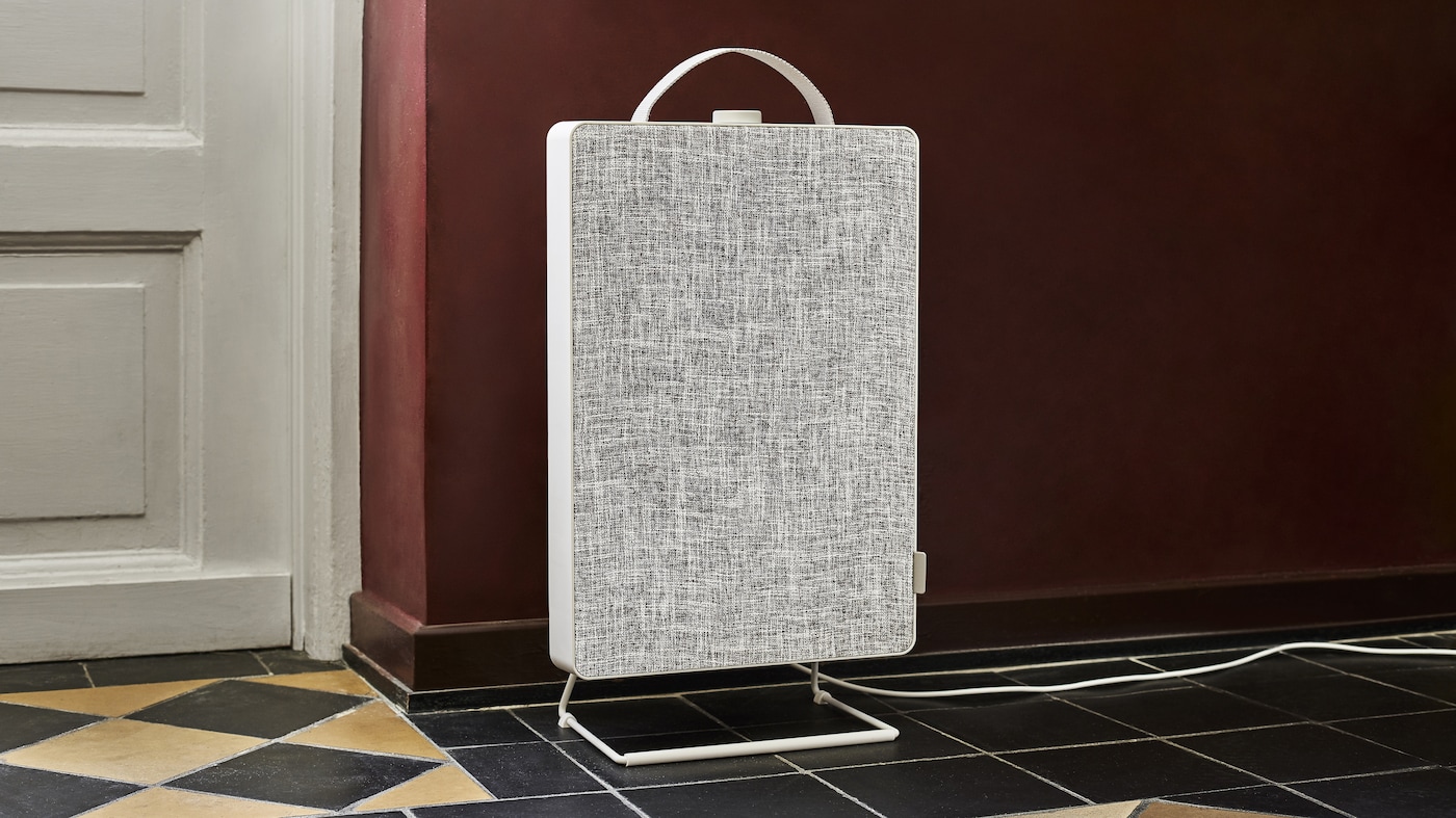

It might be effective for small room, ikea gives detailed specs .How good are the Ikea air purifiers in removing pollution? Wall mounted /stand Purifier + AQI monitor for 5639 and they're willing to ship to me. Looks classy compared to the boxy ones.

Its slightly above my kneecaps. There is a chair version that you can try to make part of the room if space is an issue. It wont hang off walls.That round purifier is available for me at close to 5k. But looks huge looking at the pics. I wanted something to hang on the wall and this round thing does seem to have a wall mount option.

Thats just mindless reviews with a specs porn fetish. Not saying others are bad, but this one is good too.I saw some YT reviews and they mentioned these IKEA air purifiers only have Hepa12 filters. Most good/better air purifiers use Hepa 13/14 filters. So i put off buying the ikea purifier.
I have sensors to verify and rn in my room PM2.5 is 3 and i am using fan speed 3 ( max 5) and my room does leak in air.
I have used it on multiple occasions to bring down PM2.5 from about a 100 to <5. Did not time it but under 15mins i think, definitely under 30mins.
Air purifiers are used in a closed room and air circulates multiple times through it. 99.5% vs 99.9% isnt making much difference and airflow will matter just as much.
There will ofc be AP with better airflow than this one but at 5k its a steal and is functional enough for a room. I am happy with it anyway.
Filter cost is reasonable at 1k. I bought 4 just in case.

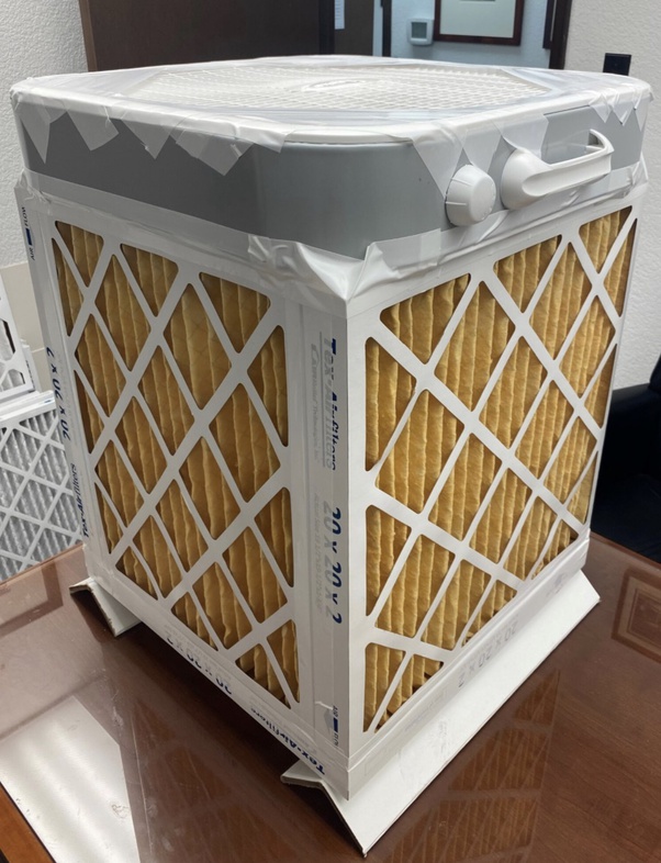

Duct-Taped $70 DIY Air Purifier Outperforms $1,000 IQ Air – Smart Air
You get what you pay for with air purifiers? New test head-to-head data shows $70 DIY purifier effectiveness higher than $1,000 Swiss purifier.smartairfilters.com

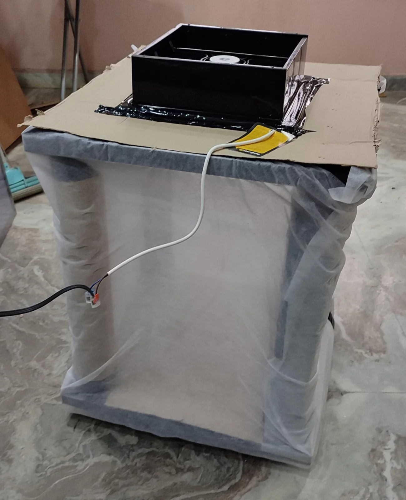

Here is a discussion on something similar to Corsi-Rosenthal box, you can make at home.
That's two fridge/washing machine stands (Rs 350 each) where one of them is flipped and their feet are connected to each other with four tubes made out of cardboard. Bottom and top are closed off with more cardboard and a 250mm exhaust (Rs 1300) is installed in the top.
Filter material is two overlapping disposable bedsheets (Rs 10 each) and needs to be changed every two to three days in a tier one city.
Of course, there's plenty of refinement possible in this design, like using agriculture 4" pipe instead of cardboard tubes, and mdf instead of cardboard sheets.
