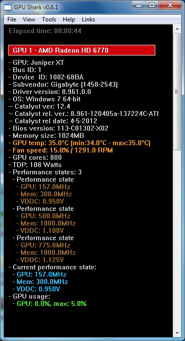

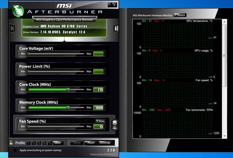

Clearly, the card is not getting enough voltage. Default voltage for HD5/6770 at 850/1200 is 1.125V. So, just download MSI AB, post your voltage, we will help you after you post your voltage. At 775/1000, the manufacturer must have reduced voltage to keep the temperatures under control. Hate to break it to you this way, but I think that maybe purchasing a downclocked card was not a good idea, because naturally, the manufacturer must have cheaped out on components. But if you get lucky, you could be able oc it at stock HD6770 with a voltage bump at stock i.e 1.125V. But don't expect it to reach much, past that.

Your core voltage/Vddc at full load is the default 1.125V. So its not undervolted.
Your GPU core might be able to do 850, since they do not follow speed binning religiously. As Gamer1120 said, even the 6750s are clocking well.
However your card's memory chips will most likely be rated only for 1000MHz clocks, so they might not overclock much.
