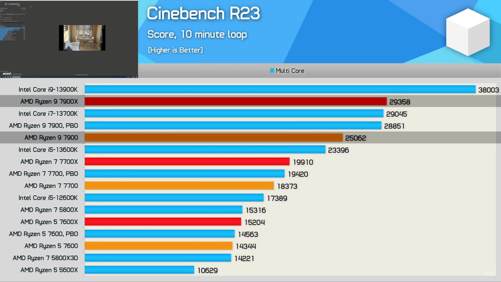

See if you can get it. 7900X is like 25-30% slower than 14700K but has an iGPU & on a platform that will get CPUs in future. Also, 14700K needs a 25k or so Z790 mobo with top notch VRMs because of its power draw & a 360mm AIO, which will push up the costs. If budget is an issue, use SN580 as boot drive for now & get a 2TB SSD later after some saving.
Thanks.. What if I want to stick to the i5 which z790 motherboard would u recommend and which cooler
79k with Z790
72.5k - you lose out on OC (incl. UV) & 3rd M.2 slot mainly. IMO just get the i5 13500 instead, that is a better value for money CPU in my books.
FYI - 13500 scores around 21k & you need to enable 105W ECO mode on Ryzen 7000 X line

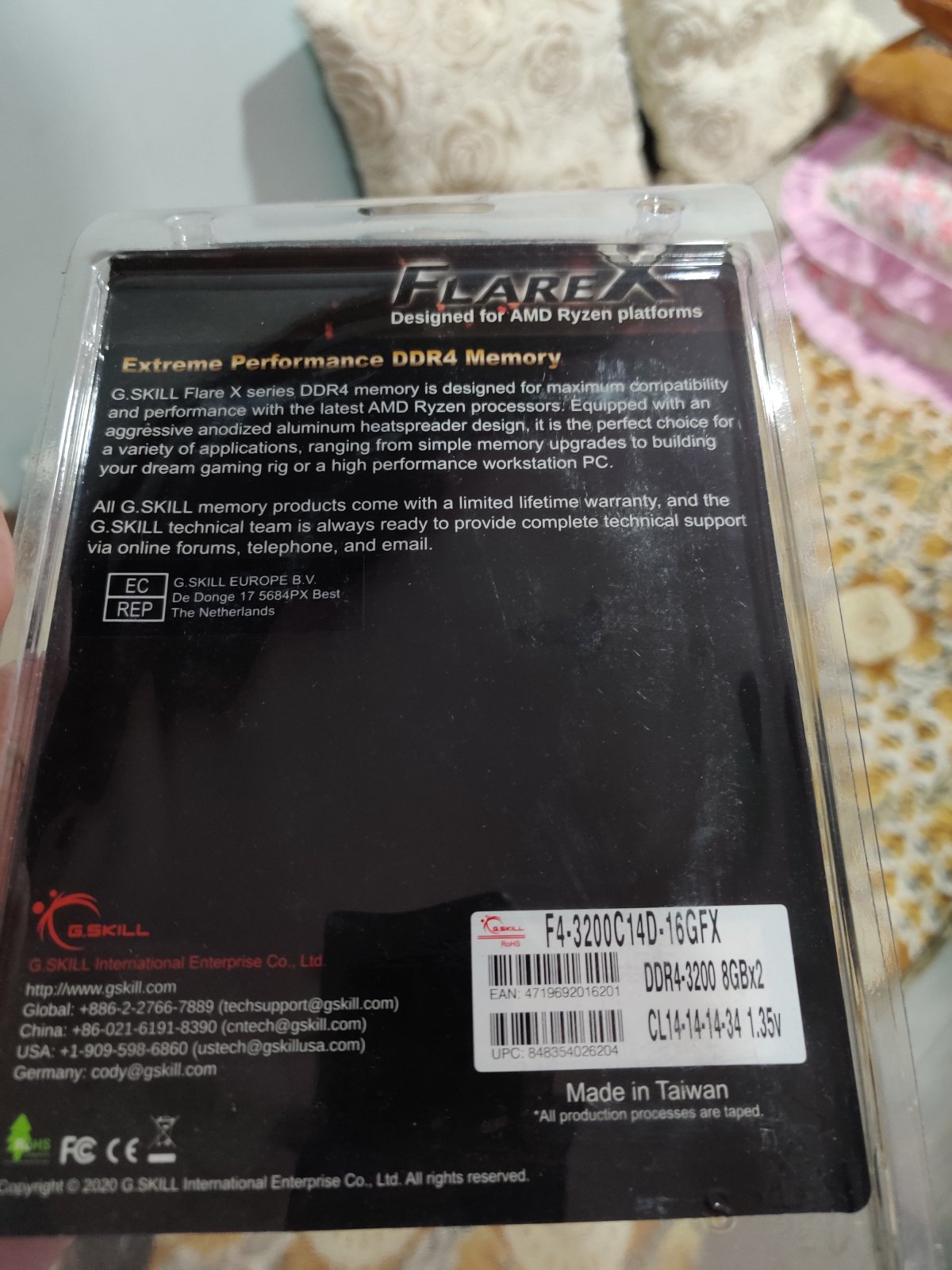

This is my current ram kit baught from a member from te only
DDR4 3200MHz CL14 is considered top-notch, only behind 3600MHz CL14. As you are not considering AMD & will use the rig mainly for productivity, get a DDR4 mobo. 2TB primary SSD will also fit easily. CPU upgrade is also possible but even i7 13700K can get to 250W territory, which will impact the cooler you need. IMO i5 14600K is enough, just save the money. Mobo should have USB BIOS flash, look into it.

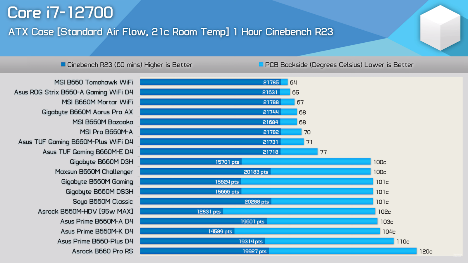

VRM is the issue on Asus Prime, you need at least TUF. Its VRM looks similar to Prime B660M A tested below. Note that i7 12700K is a 180W CPU like i5 13600K, so it is already getting throttled at 100% CPU load + India is a hotter country to have 21C ambient:
I have Gigabyte B660M DS3H with i5 12400 (80W at max performance). I use my rig for gaming where CPU power averages around 45-50W but still I see VRM temps of 80C. So in a way no upgrade path for me, although using i5 14600K for gaming should still be ok on my mobo, just that it can't handle sustained 100% CPU load like video rendering.
