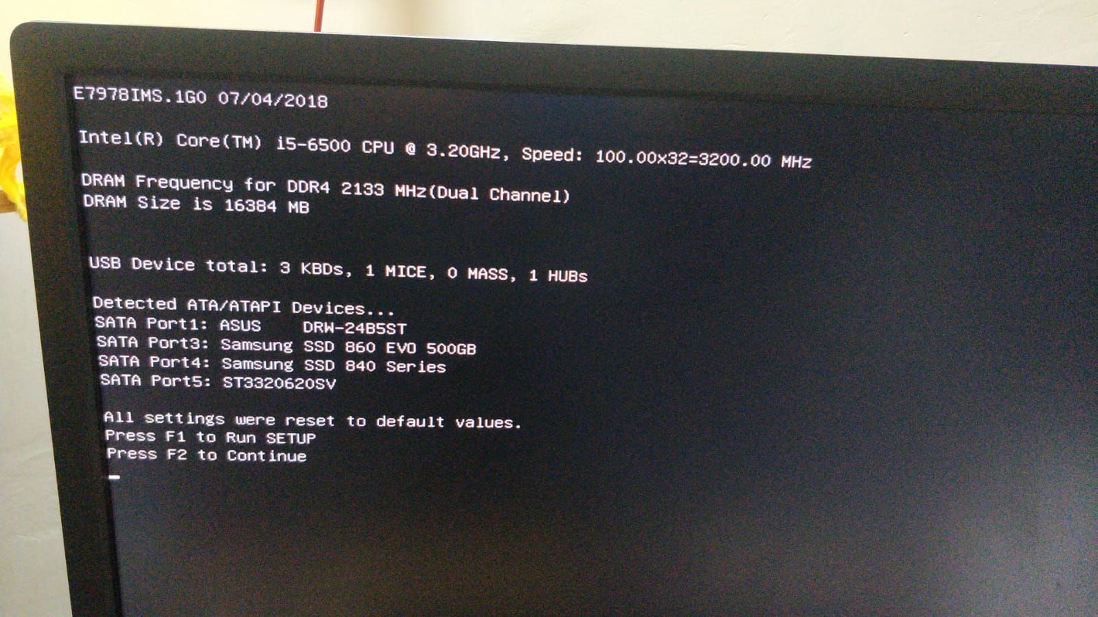

can anyone advice me regarding the below error. This is coming during start-up since yesterday. Once i press F2, normal boot is taking place. I didn't dare press F1 and check what happens.. :confused:.
If the time is resetting every time then you need to change CMOS battery as suggested by others. You can it at any electrical or watch shop.
But if your system is maintaining correct time then you need to flash the BIOS.

Funny thing is that the time was not getting reset.. and the problem vanished after two days.. no clue what happened.. Most probably the BIOS @lockhrt999

Time does get reset but it perhaps also immediately syncs from the internet on boot.

The time later syncs from the net, so a reset of the battery is definitely a CMOS battery issue. However, in the past, also had the issue when the seating of the battery was incorrect, even though battery was fine.
