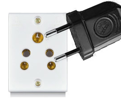

Checking power leaks and earthing is an exercise I don't want to get into, as it sounds like an extensive undertaking.
Checking earthing is easy. Take any 2 pin appliance like AllOut or mobile charger and plug it in socket diagonally. If it works then it means your earthing is fine.
Looks like earthing is fine, diagonally plugging in Allout was working.
Anything more than a mobile charger should trip your circuit breaker though.. something to keep in mind
