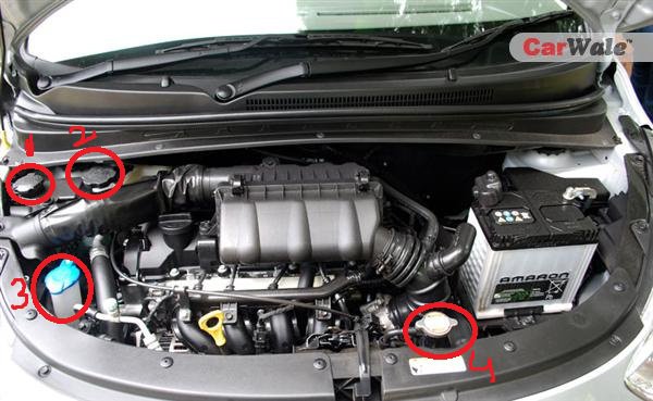

I have got my Friends' new i10 for 4 months. Never had a chance to know a four wheeler well. My question is, where do we fill water in Hyundai i10 Kappa2 Sportz :ashamed: I mean there are two lids in the bonnet, which one to fill?

Sumit thats for wiper water :p. I am talking about engine coolant + water mixture. On the first lid its written engine coolant but the reservoir is not transparent so unable to judge the level of coolant. :(
Funny thing, but even I don't know that after owning it for nearly 1.5 yrs. :)
I will check with my friend who also owns i10. But my best guess is no. 4. But I have not needed to fill water + coolant for whole of my ownership. Why do you want to do that? When was it last serviced?

I hope you know that if at all you want to top up the coolant, you can do so with Distilled water or else ready mix coolant or else you get concentrated ones which are usually mixed in 1:1 or 1:2 proportion with distilled water. Do not use normal tap water in your radiator. Also there must be a reservoir for the Coolant,thats where ideally you should top it up. The bottle had markings on it, 'Max' and 'Min' on them.Keep the coolant level around the Max mark.No point filling it to the brim, it will drain away through the overflow pipe anyway.
Thanks Darklord. I didnt use tap water in my radiator. I filled up water in a reservoir "no.1", its written engine coolant on it. So I guess filling up a little water in that reservoir wont be harmful. But as you said, I didnt find min max mentioned on any reservoir here.

no 4 is where you put radiator water(coolant water)
