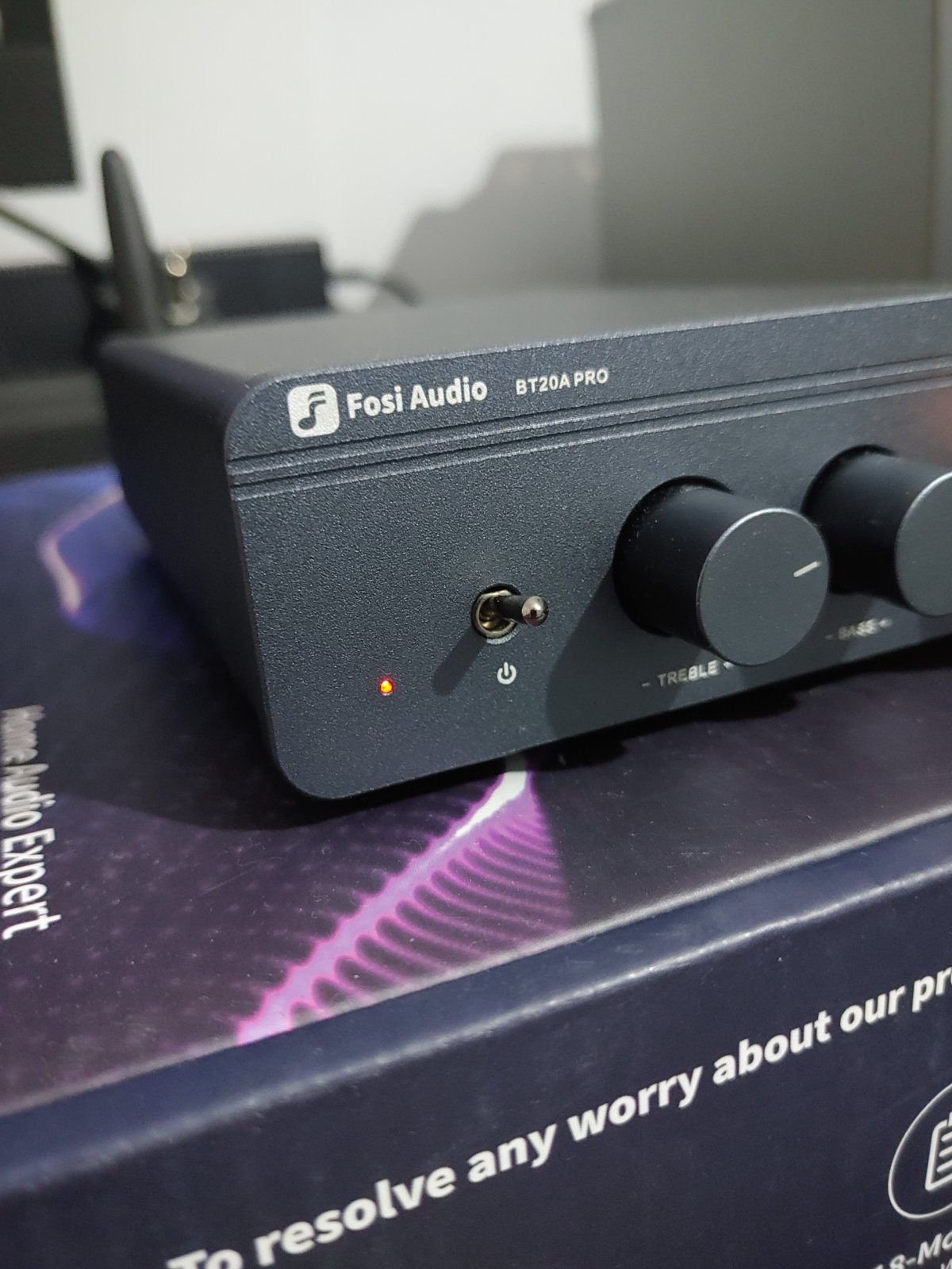

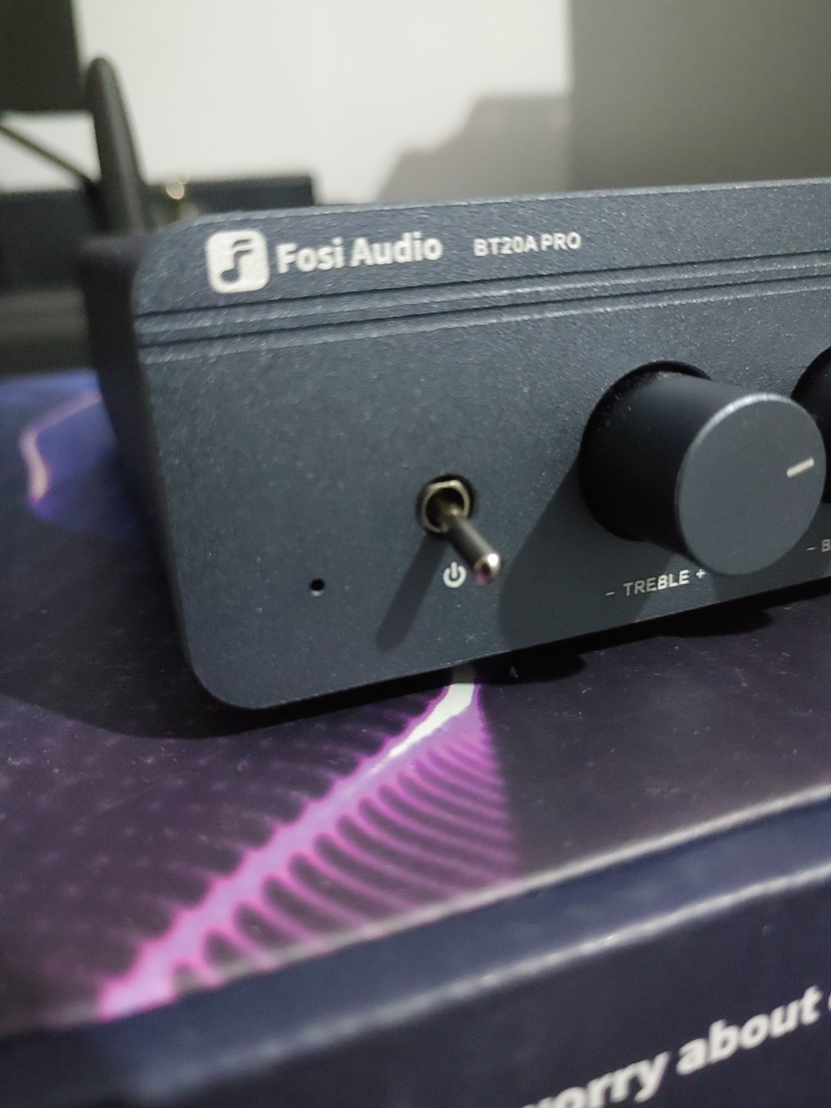

1.. Sharing pics of the power on and off state of my amp via the switch that is provided on it...
This below pic shows its on and ready to fire music..
This pic shows the switch in off position... So I guess that's what standby is

1) It’s very hard to say conclusively whether that power switch is cutting off the mains power to the amp or triggering standby. You can definitely leave the smps on and take a subjective call on this power switch. Leaving it on won’t hurt either. I have at least a couple of small class D amps that are always on. And if you think about it, so are the class D amps on all smart speakers and the likes.
This looks like a mechanical toggle switch, which in combo with the DC input on the back, suggests it physically disconnects power from the device. I.e it is not stand-by, it's actually off. Only way to know for sure would be to open it up and check the wiring, or measure the current when the switch is off.
Right so it seems there is no standby feature in the amp.. Strangely the company representatives advocate to keep it on all the time, acc to them it doesn't consume much power...
But despite no music streaming when idle the amp tenians pretty warm hence it definitely is consuming enough energy..
