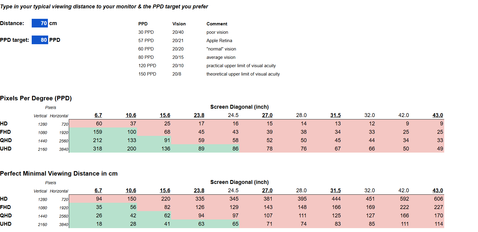

About 70cm of distance with media consumption being priority, and sub 25K Budget.
I am happy with 100% SRGB, 90% DCI-P3 and 80PPD.
For PPI, I am referring to this sheet by Techless:
Link: https://docs.google.com/spreadsheets/d/1bsaXxiZ3TC-u__xTt309WK8-1yvzTqFLhat3z5qwwe4
With those things in mind, I tried to go with a screen smaller than 27 inches to meet the PPD target.

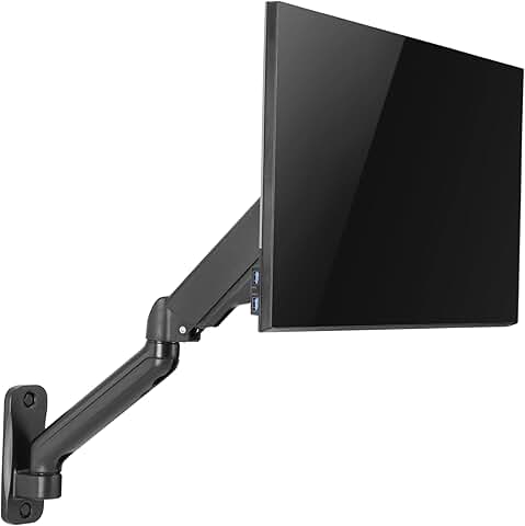

Do you think something like this will be enough for a 27-inch screen for a wall that may not be that strong(if you drill hard enough, you can go from one side of the wall to the other side)?
Link: https://www.amazon.in/dp/B0CTTM72L6
Its specs say - supports upto 32"
ARTIKEL Single Monitor Desk Mount | VESA Mount with C Clamp & Grommet Mounting Base | Computer Monitor Stand for Screen up to 32 inch | Table Mounted |​
for a wall that may not be that strong (if you drill hard enough, you can go from one side of the wall to the other side)
This Monitor mount is for - DESK/TABLE. Wall mount are different. I guess you have 4" thick wall, if wall is of Red Bricks with good mix of cement and sand, it can easily take up load of monitor, if wall is made of AAC blocks then thats entirely different scenario.
Reactions: Mjay
Forgot to mention - Check that monitor supports VESA mounting before buying - required for using monitor stands/mounts. Also, Refresh rate above 120/144hz to be preferred.
