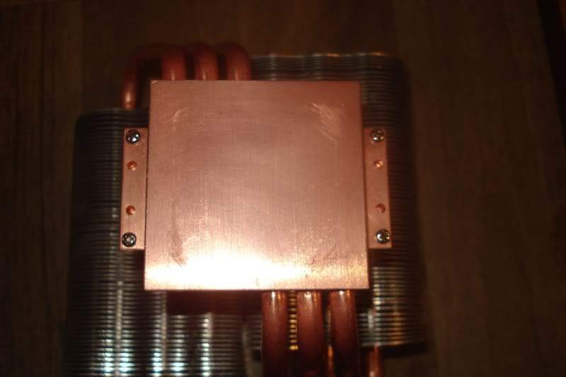

As ad1tya recommended, I used lime extracts. Given awesome results
Went back to its standard colour after 2 days but oxidation wasnt present at all. Rubbed the copper base with cotton+isopropyl alcohol before mounting and lot of dirt came out. Kept on rubbing it was clean.
