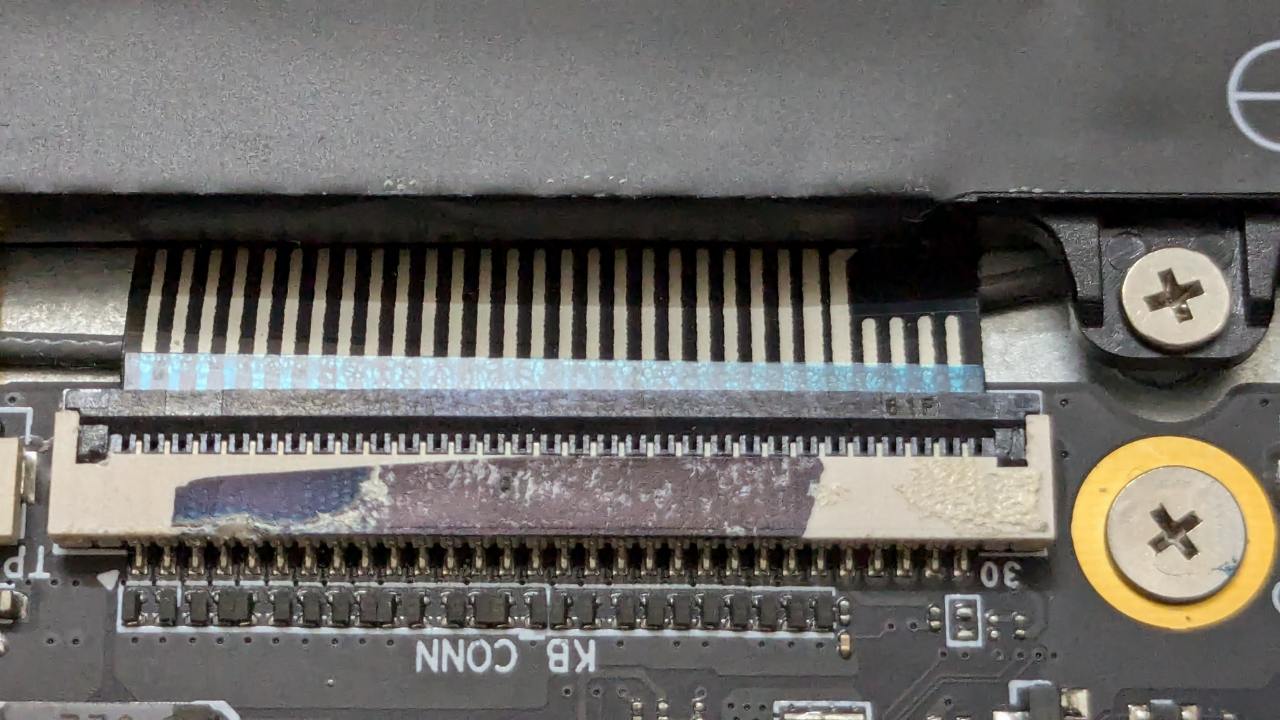

I think it's keyboard problem. I tried logging in automatically with live mint usb drive and the entire os started to not behave properly after a few minutes. Trackpad stopped responding. On desktop, the search bar opened up and the [ key was filling it up. I tried to remove the laptop ribbon cable but it is right next to the battery. I don't know how to open this. It's too small for my hands to grip anything. I'll need to buy some tweezers set now and a good pair of magnifying glasses too. Worst case scenario - I'll cut the cable with scissors.

The connector cable appears to be misaligned. Assuming you did not misalign the cable, try using some good cleaning liquid and make a good connection.

You need to pull up on the black bar (on which 61P) is written. It should open with just your fingernails. Put your fingernails under the black bar and over the blue part of the cable and it should pull up, unlocking the cable. Don't try too hard. If it is too difficult to open maybe you need to push the black bar towards the blue section and then pull up. In either case, if you need to put too much force, you are doing something wrong. These locking mechanisms don't require much force to open.
I tried both ways and couldn't budge it. The middle of the black bar comes up a bit. These things are too tiny to touch so I'm waiting for some tweezers from Amazon. Look at the resistors on the board. Those are like 1mm in size. Probably laser soldered to the board. These miniature circuits are hell to see and do any repairs.

Update: i managed to remove the keyboard cable. That clip moves up as @codwapeace suggested. I used a tweezer to push it up and after a bit of force it opened without breaking. Then i just used the tweezers to remove the cable.
