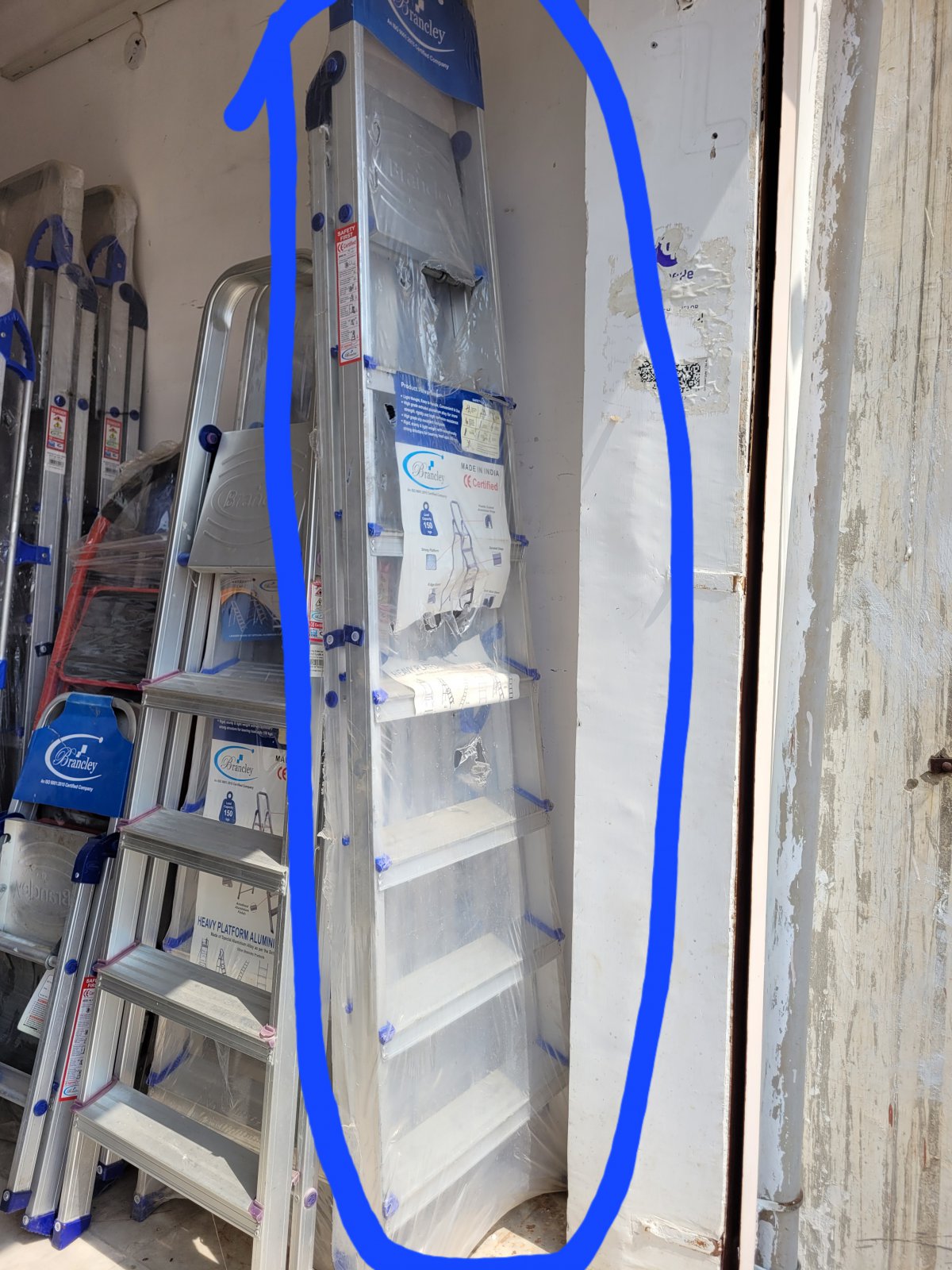

Just came back from a local hardware shop. He had 2 options for 7 step aluminum ladders, for the first and best one he quoted 6K (with 10 years replacement warranty), for the second inferior one (5 Year repair warranty) he quoted 4.2k
This is the one he asked 6k for:
That's almost same as online prices.
There is no such thing as repair for these ladders. Maybe these guys can fix it but safety regs are always to replace with new. I'd go with replacing over repair if it's genuine. Ask for the terms. Thee people have ways to weasel out of such agreements.
4 inch deep steps, its no better than a bathla and bathla is better known :meh:
I have almost the same one as the 6k model by the looks of it I'd say local is mush better then whats being sold online. I bought mine back in 2010 for about 3k it's a 6 step.
