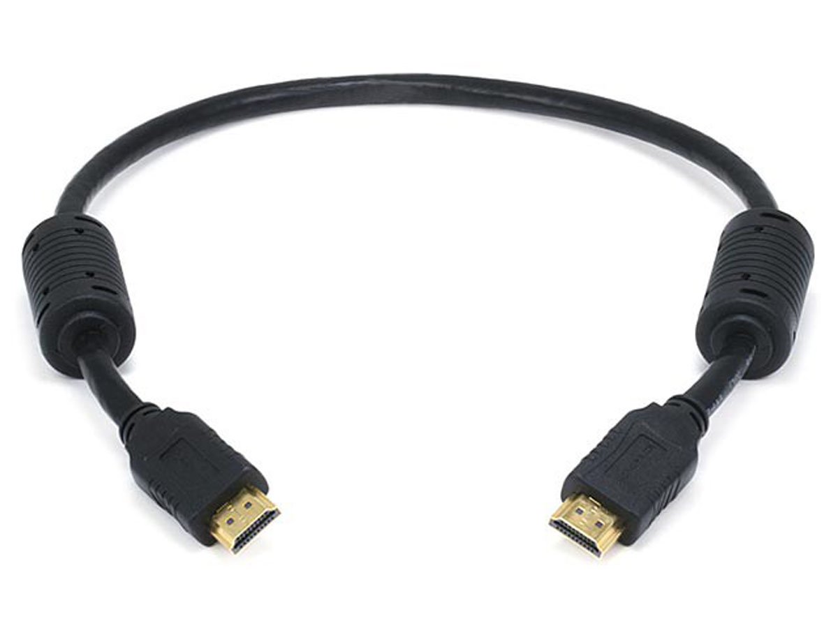

I don't remember exactly which cables, but if they are the flat ribbon-like HDMI cables then they are not shielded and are a bit long as well.
If you have an electrically noisy environment, the best HDMI cables for you are:
1) as short as possible for your application
2) not flat but round (twisted cables pick up less noise)
3) shielded as per the manufacturers description
4) with ferrite cores at one or both ends

Something like this, short, round and with ferrite cores, should be most noise-resistant.
Couldn't find that exactly on amazon, but perhaps this or this?
