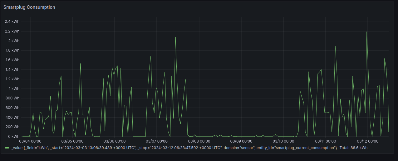

it's a non-inverter fridge and it's compressor cycles frequently at max setting and during those cycles, It consumes around 950W. Attached a graph showing power consumption over the last 8 days(fridge was off for 2 days). 86.6kw used

Right, which means it has a high surge or inrush current every time the compressor begins. Mine measured around 2kW by clamp meter with surge facility.
Yours are in a similar ballpark. However these surges are momentary for a fraction of second. I think the energy measurement of both your meters is being thrown off and reporting larger than is the case.

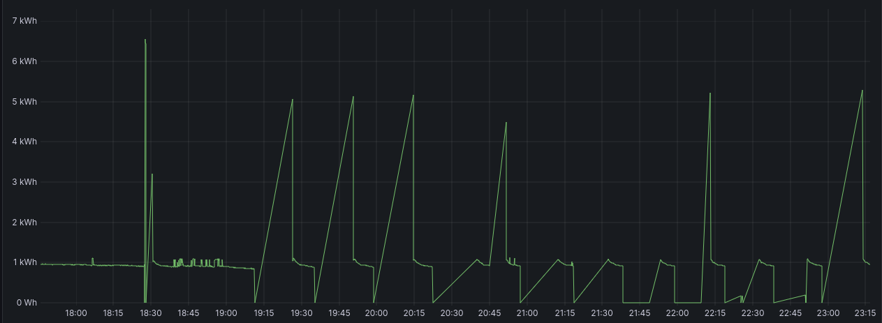

It does momentarily surge to 6KW. I have used it with other inductive loads in the past and I do feel the numbers are accurate and I don't want to buy this Meco meter for now. (Attached graph is instantaneous power consumption, previous graph was kwh calculation by doing integration with 1h time intervals)

See the second spike at 19:15 taking ten minutes to reach max units of 5kWh (!)
That is obviously wrong. Of course the integration will show higher power consumption over time. If it can measure instantaneous power than it can measure rms. But the totals part is buggy. Why don't you post these figures in the device forum and see what you can learn.
There is NOTHING in your fridge that consumes that much power for ten minutes. If it's frost free the heater consumes (in my latest fridge) around 200W only for a half hour.
As I said inrush current is momentary. Happens in an instant. You will get this every time your non inverter compressor spins up. You cannot catch it with any clamp meter. Only one with an inrush measure facility.
Maybe it an handle inverter inductive loads OK. Those have a gentle ramp up.
But it's clearly failing with your non inverter fridge.

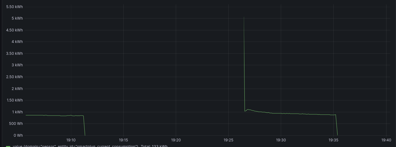

@blr_p it didn't take 10 minutes to reach 5kwh. The graph I shared is unfortunately a bit misleading.
There was a power outage. When power came back, There was a surge to 5Kwh at 19:26:26 and it settled down to 800W at 19:26:29. Added a rule to disconnect lines if interval between value is larger than 1 minute.
Ah
800Wh is quite high. My kelvinator used to hover under 150W.
