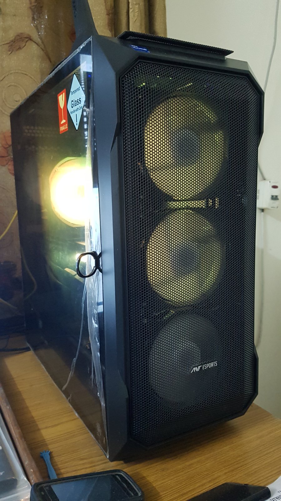

only 1 thing am noticing is my cabinet fans are kind of weak for air flow ,so i ordered Noctua NF-A14 and F12 ippc 3000 variant ,which i will get in a week ,

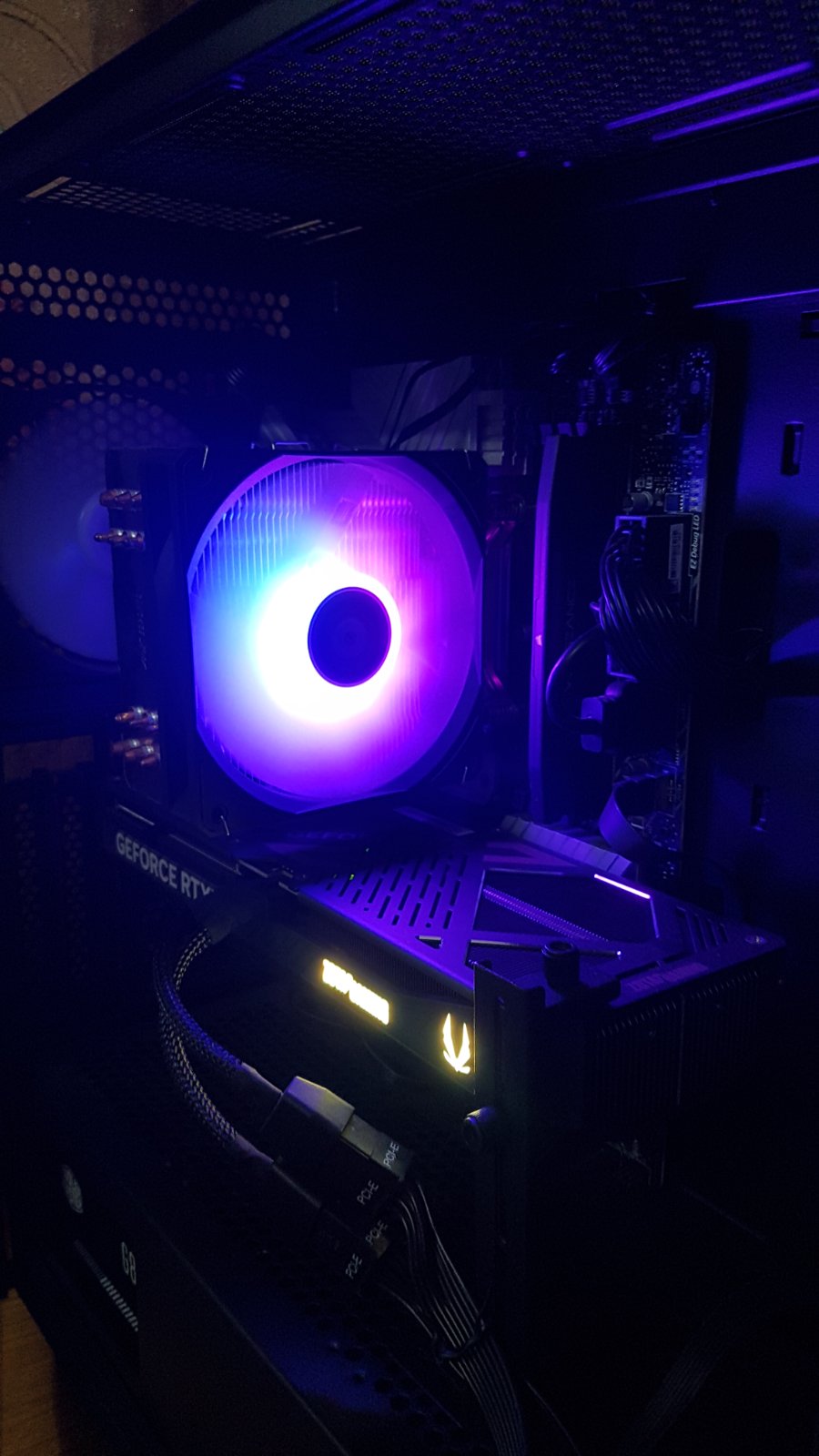

An Ant Esports air cooler just won’t cut it. Good call on upgrading the case fans, but you’ll likely need a solid 240mm or 360mm AIO to really tame those temps under load.

So what happens is that the GPU pushes hot air from the right edge of the card. This hot air is then taken into the CPU cooler, which makes it even hotter. So those 4 heat pipes are sufficient for lower 65W to 100W(maybe). So 14900k produces way more heat ig around 220w+, so u will need a better cooler that is rated for this power and temps. Something like 6 to 8 heat pipes and a dual tower cooler, or a 360mm AIO, must do the job. I have a 14600kf and 240mm, and still suks with the contact frame tbh(SFF). So, try to create a neutral air pressure inside the case for optimal temps. And also don't get a cheap aio. IDK why this is cheap, but here ya go get this (contack frame) other brand is thermal right.
