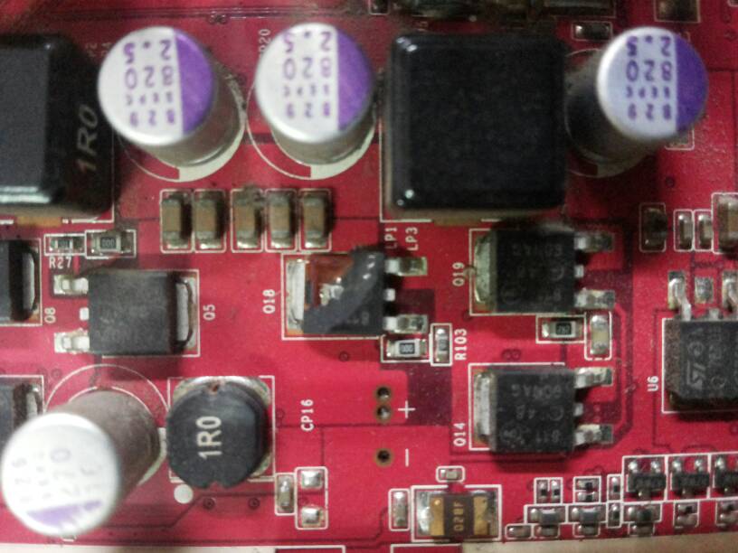

Last evening my PC went bust. Motherboard was fried thanks to something going wrong with the UPS. Both my HDD is gone. Funniest thing is I had used Yadis to backup data from 1 HDD to the other and now both are gone. God knows if the processor & ram survived or not. Will come to know in the next few days.
are you sure the motherboard is bust or is it just the SMPS.

Board & SMPS are not the only ones I am afraid. Both hdds are gone & so is the graphic card.
When it sparked it blew an entire chip on the graphic card.
I am just hoping the processor & RAMs survived. I don't want to upgrade till April 2014.
Which UPS was it ?
Rectified voltage to the mobo can do this sort of damage ?

Which UPS was it ?
I had a lightning stirke close by once, sent a surge through the earthing, which travelled through the nic and blew out a laptop nic connected via cable. Nothing else was affected.
APC 500 VA.
Lightning has struck me once as well but all it took out was the motherboard.
The problem started a few months back. I have a custom chimney like contraption in my desk as there is no space for the rear exhaust air to leave which caused my PC to heat up. So this contraption fitted with a small 5 inch exhaust pumped the air upwards. This fan blew up once. I fitted a new fan which also blew up a few months later. Then my speakers went up in smoke. All this while I thought it was a power fluctuation.
On Saturday evening when I tried to start my PC it wouldn't start. It had done this before. So I opened up my cabinet tinkered around a bit and tried to start the PC. A huge spark and then everything it was over.
The technician told me the UPS if old can be a cause. The UPS is old and I had noticed that at times when I was using the monitor with my PS3 and I started the Monitor before the UPS had settled down it would cause the monitor to loose the signal. That was not the only thing but I could never really put a finger on it and I am not sure I still can but if the UPS is the culprit then I will have to pay dearly for my aloofness.
