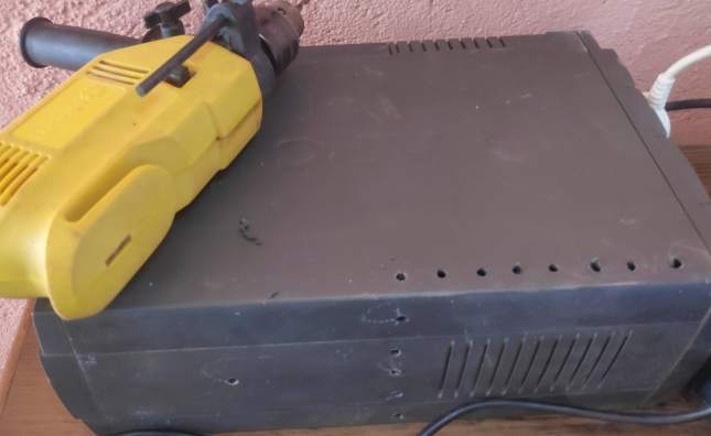

well i have a NUMERIC 1KV 600W UPS for my PC, It became faulty and gave continuous BEEP for after working fine for 1-2 hours and switches off abruptly, creating havoc in my PC, as i got frustrated, i went to a UPS repairing electronic shop, they told me that MOBO in the UPS is faulty, its better to buy a new one instead of repairing this, it worked plumb for 7 years, and i was frustrated,
so I did not want to GIVE UP, hence i used my common sense, everytime it beeps with faulty red led, i sensed the UPS was struggling to dissipate the heat out, so i gave a try by accomodating 2 decent ordinary small fans (could be 80MM fans), on either side of the TRANSFORMER LOCATION!! for air flow as a last resort testing before i would throw away the UPS to Garbage collectors... And it worked wonders, i spent 300 Rs, by god's grace now the UPS is going good! don't forget to have a switch for the fan!!
