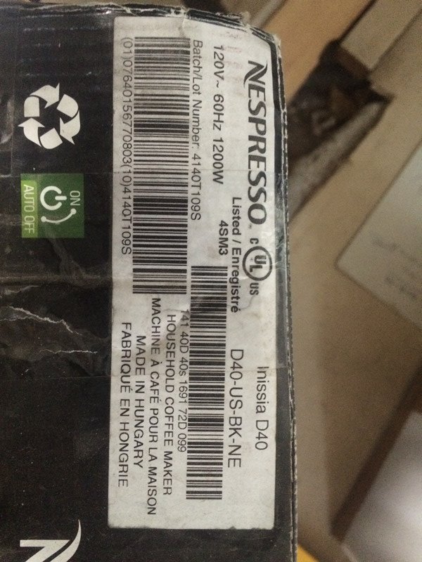

I've attached the photos of both the appliances.
I'd also like to mention that the same appliances sold in some regions specifically mention 220-240v 50/60hz. So both frequencies are mentioned in those regions.

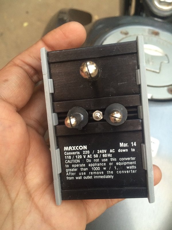

Hi Friend's,
My friend has gifted me an Nespresso Inissia machine, Hungary made model. without an Transformer.
Please guide me as i have purchased an Transformer. (Pics attached) will it be compatible with the machine or required to purchase a new one.
^^ your converter is rated at 1000w but your coffee machine needs more than that. you can still try it for few minutes... if it becomes too hot then don't use it.
Please buy one of the heavy duty ones like I have. I'm quite certain that this type will damage your machine even if you buy one with the correct power rating.

Hi Friend's,
Please guide me as i have purchased an Transformer. (Pics attached) will it be compatible with the machine or required to purchase a new one.View attachment 54584 View attachment 54585
Maxine makes good step-down transformers . Look on Ebay.in , Amazon.in
As another FM pointed out, ensure the wattage rating of your step-down transformer is at least equal if not greater than the wattage rating of your device. In this case you need at least a 1200W stepdown if not a higher wattage. Don't use the 1000W transformer in your picture, since those are not meant for sustained high wattage loads. They can burn out on continuous load and given that your device needs a greater wattage than the transformer, the burnout risk becomes even more likely.
