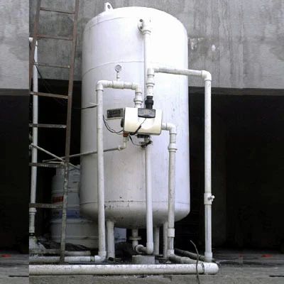

There are 2 kinds depending on the hardness of your water
<150-200ppm - water conditioner system (3m and onestop+) this system uses TAC resin which essentially makes the calcium and magnesium ions somewhat inert thus reducing scale. There will still be some scaling but very less.
>200ppm - water softener (3m, ionexchange, Kent, Eureka Forbes) this the traditional water softener which uses a resin which takes out the calcium and magnesium from your water and replaces it with sodium. This type requires salt to recharge every cycle and the frequency of this cycle depend on your water usage and softener size.
Both of these systems comes in various sizes and depending on your need you can choose what works best by calling the reps from various companies for their suggestions.
(I'm also on the lookout for a solution for hard water for my new house (under construction) and this based my dialogue with reps from all the above companies)
