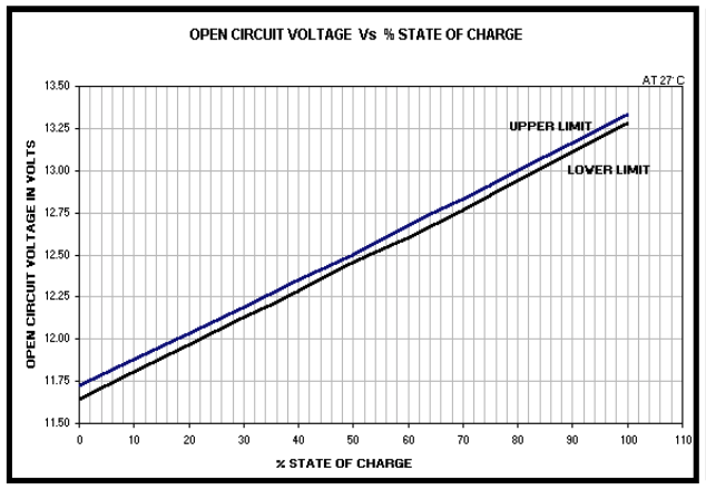

So this question has a multifaceted answer. Amaron publishes datasheets for their Quanta batteries, the datasheet for this battery shows a State of Charge chart based on voltage at the terminals with nothing connected to it. I charged the battery at 13.8V for 24 hours, let it rest for an hour and then measured the voltage and cross referenced the chart:
I measured 13V, so that's right around 85%. However I could be reading this chart completely wrong (or what it's for) so I'm going to do an actual capacity by connecting a few headlight bulbs and see how long it takes to reach the safe cut off voltage that's in another table on the datasheet:
I'm thinking a 18A load (4x 55w bulbs) until the voltage drops to 10.2 should return a value that's close to 72AH (85% of 85AH). The maths get a bit mathematical at this point and I might need to consult with someone more intelligent than me to figure this out. But that'll be sometime next week.
I measured 13V, so that's right around 85%. However I could be reading this chart completely wrong...
This chart seems to consider voltage reading immediately after charging.
100% SoC should be 12.65V open circuit for Lead Acid.
Anything above that indicates a surface charge, so you need to wait 24 hours before measuring.
More importantly, temperature and actual specific gravity of the electrolyte (how much water you added) affects the reading.
