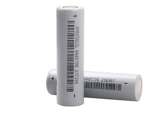

I also did a little DIY experiment by assembling some old 18550 batteries by soldering them using simple wire and putting in battery case but obviously it failed.
After doing some research I came to know that I'll have to do spot welding using nickel sheets for optimal performance. Dropped the idea since can't procure a spot welding machine.

Also having some diy ideas in mind, thinking of purchasing 6 cells of 18650 type of some okayish brand and replacing existing battery cells with them.

Spot welding required not soldering . AFAIK .
I did a kind of PoC myself before deciding on going with soldering, and it worked.
And anyways if that doesn't workout, I'll use those cells for some other diy project.
Update: I replaced the cells in the battery with cells from old dead batteries, and when putting the battery into laptop, it showed 26 percent and the charge kept decreasing without increasing while on adaptor.
I thought the issue could be in adaptor itself, and I was right.
The adaptor cable was faulty, got it changed for 200 bucks. and now it's charging.
Will try to cancel my order of lithium batteries from compoindia.
Another update: Did not cancel the order of the laptop battery cells, instead installed them in laptop battery. Haven't tested the total backup as of now.
