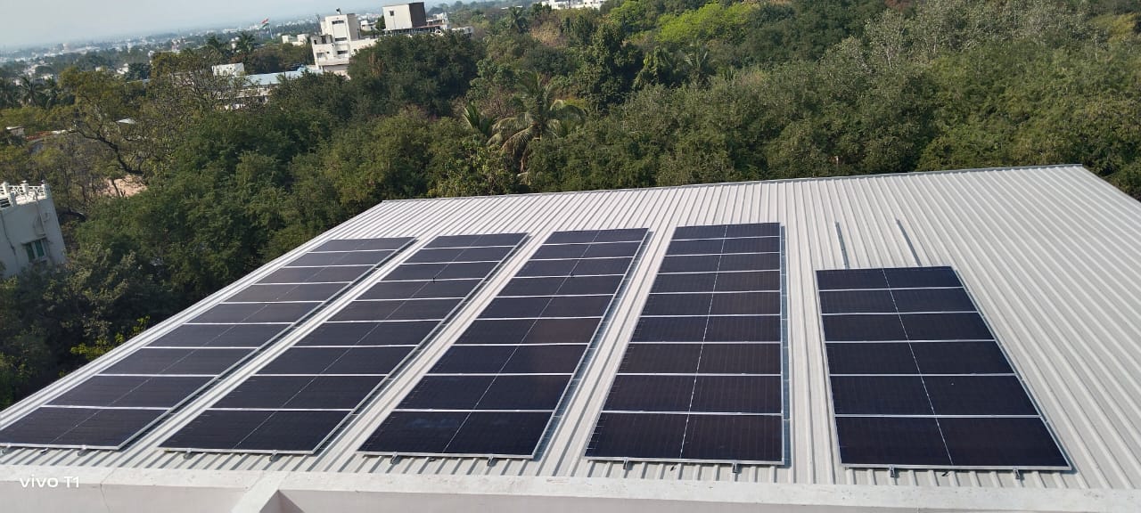

We recently installed a solar power system at our home, consisting of three 7.25 kW units and one 3.6 kW unit. The total investment amounted to Rs. 12,50,000. Additionally, we paid Rs. 18,800 (4 x 4,700) for the net meter. We opted for Renewsys bifacial panels and a Polycab inverter. Yesterday, the 7.25 kW unit generated a total of 42 kWh, while the 3.6 kW unit produced 20 kWh.
We recently installed a solar power system at our home, consisting of three 7.25 kW units and one 3.6 kW unit. The total investment amounted to Rs. 12,50,000. Additionally, we paid Rs. 18,800 (4 x 4,700) for the net meter. We opted for Renewsys bifacial panels and a Polycab inverter. Yesterday, the 7.25 kW unit generated a total of 42 kWh, while the 3.6 kW unit produced 20 kWh.View attachment 227716
Awesome, but bifacial panels have one face buried in the surface? Am I seeing it correctly?
We chose bifacial panels over monofacial due to a few factors: stock availability, a negligible price difference. But due to some last-minute change of plan, we decided to lay the panels flat on the roof instead of raising them.
Shouldn't matter much, to get real advantage of bifocal, surface needs to reflect significant amount of sunlight to begin with.
But, what I loved to hear was they were priced closely. I am also looking into bifocal panels.
Edit* hey @navino87 since it's bifocal can it be turned and it's other side used? Can that side generated the same amount of energy/power ?
