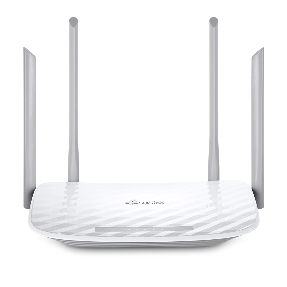

If you don't need Wifi 6, and if you don't have many devices then you don't, get TP Link Archer C7 for INR 4k. Supports WDS / AP mode / Router mode. I use a C7 in WDS mode and it works flawlessly.
You can also get an Archer A7. I believe the Archer A7 is the same as C7 but costs 1k less due to Amazon subsidy. But I haven't used it personally, so check the TP Link emulator to confirm the capabilities.
