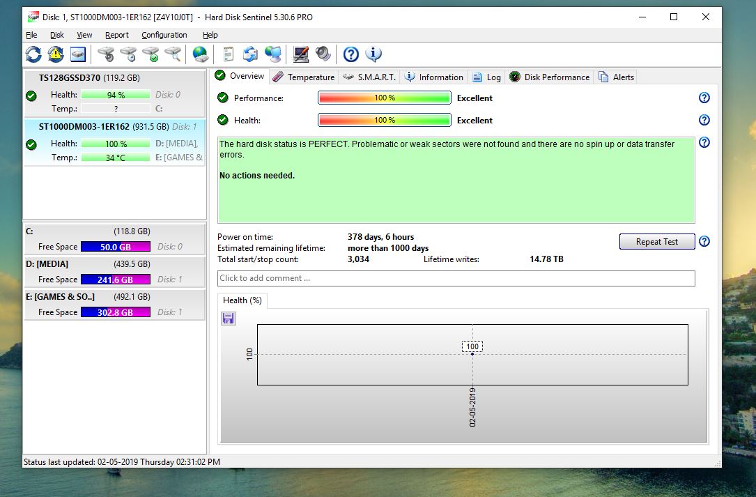

Why not run HD Sentinel and get a clear picture as to whats wrong. Also try running HDtune and do basic scans and if reveals nothing then do thorough scans.

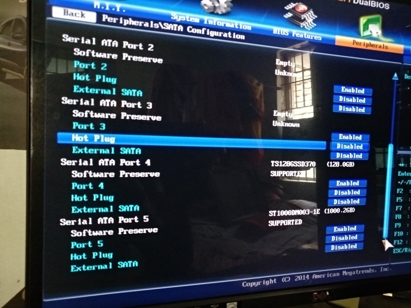

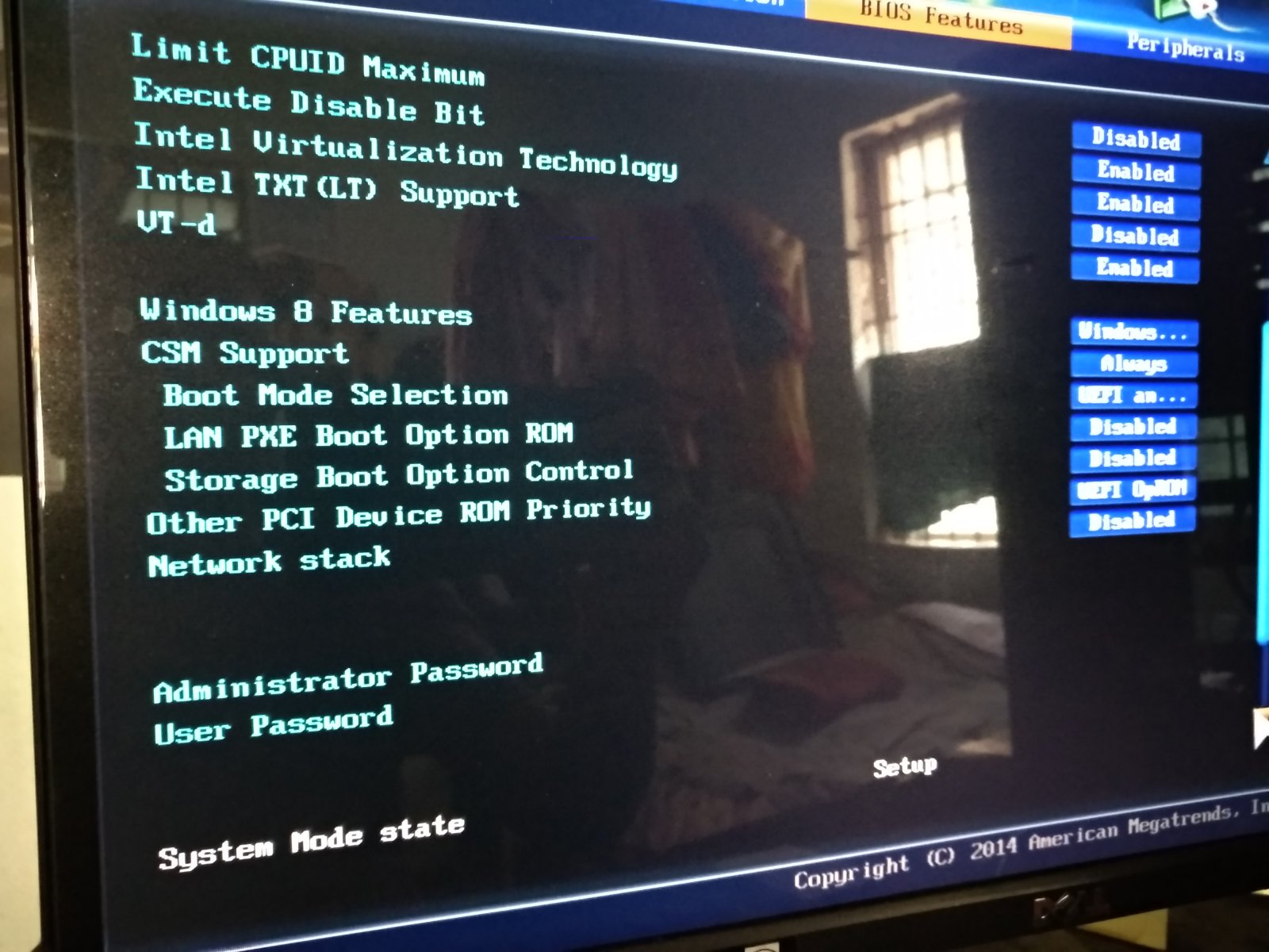

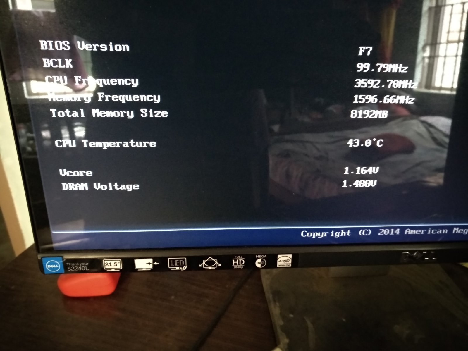

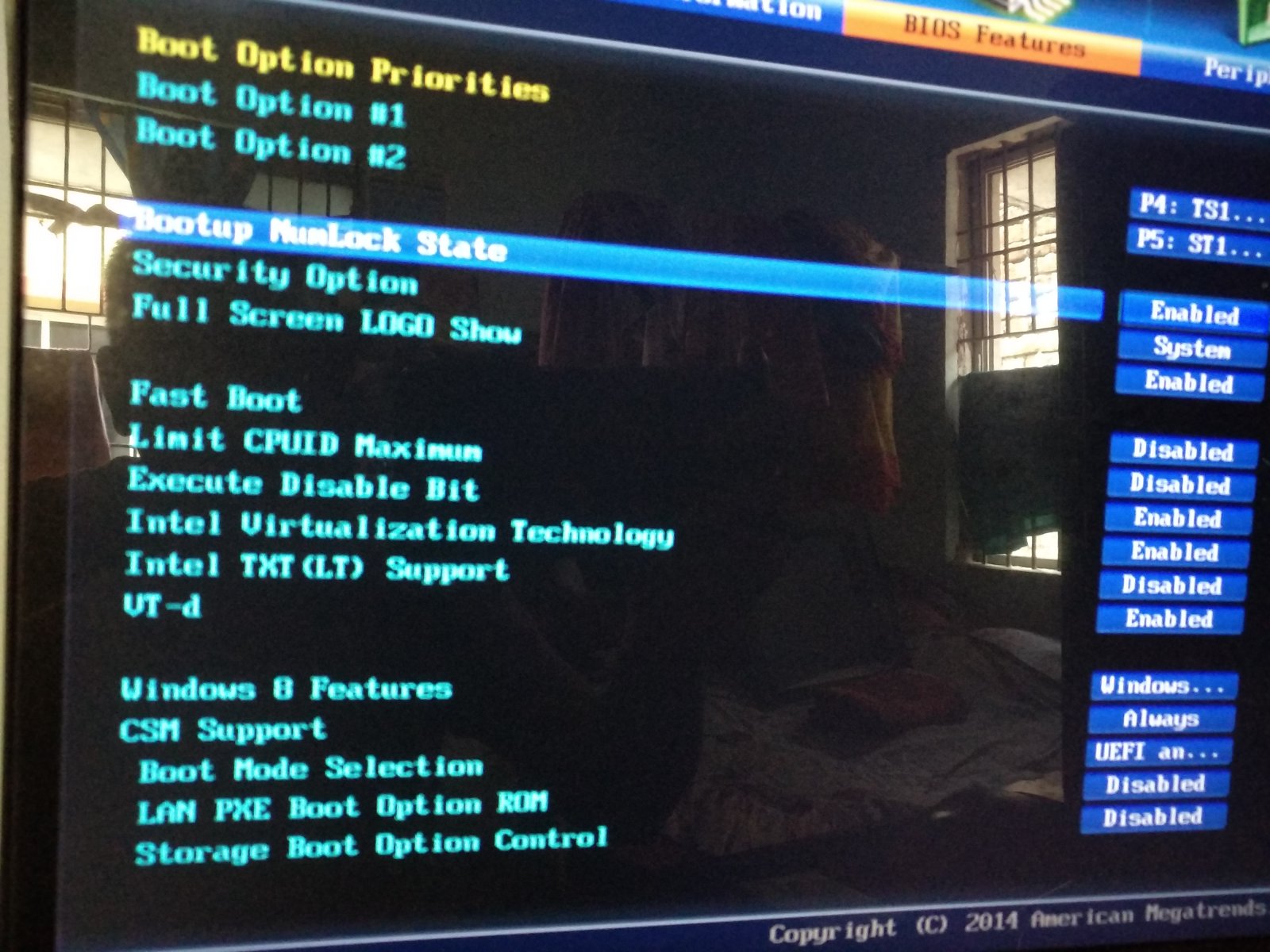

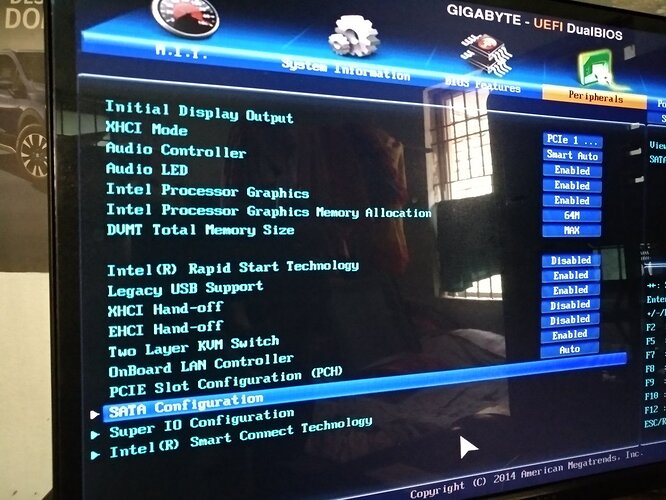

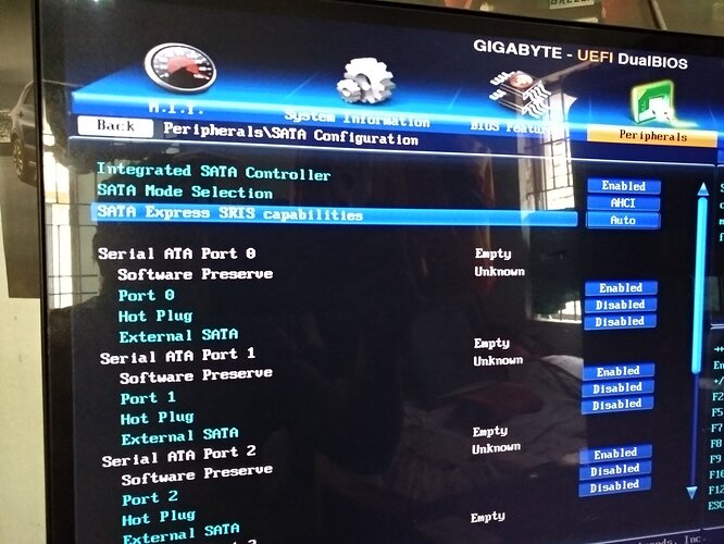

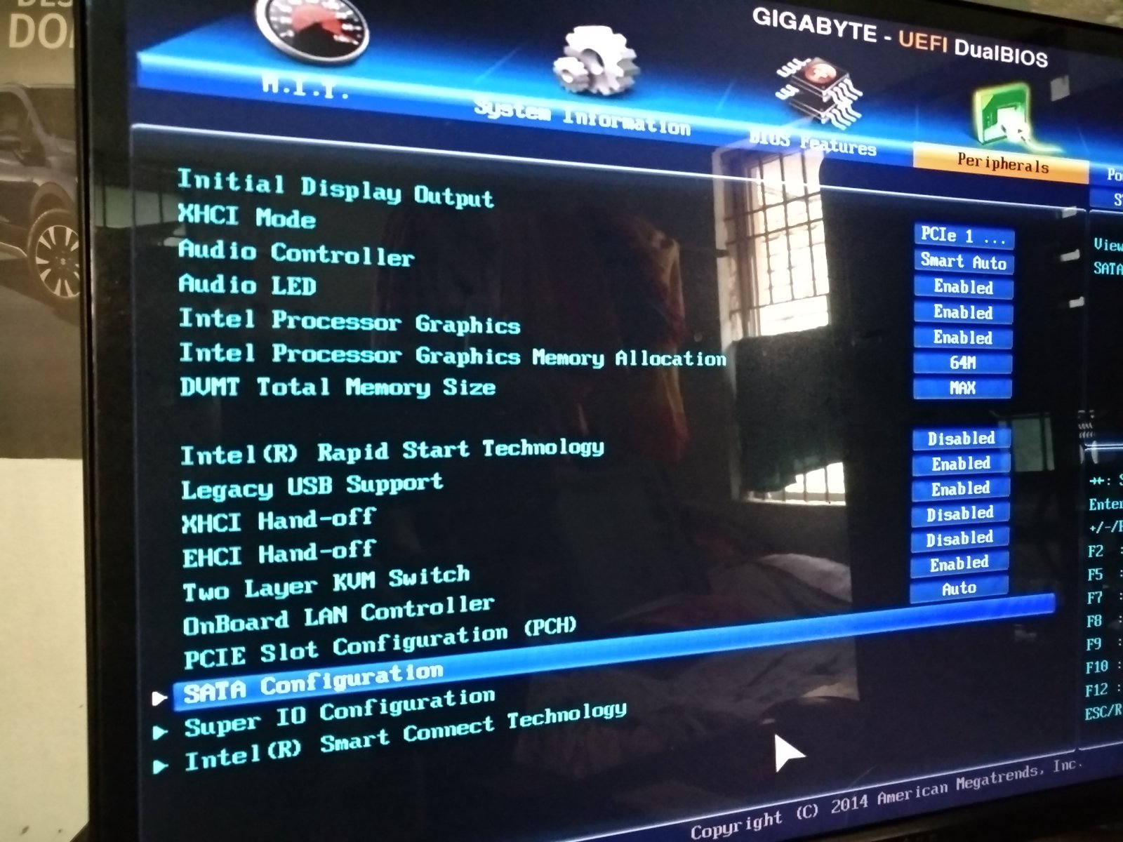

see the settings in the photos attached.which settings i have to change please tell me.

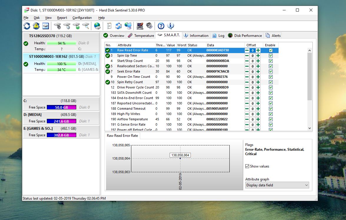

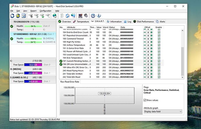

see hd sentinel images.one strange thing is that the hard disk is 3 year old and hd sentinel shows wrong date
Disable Full screen logo as you will be able to see whats actually cooking behind.
Boot mode selection: see whats available though default is fine.
Disable** Lan pxe boot
Initial display output:** If you have gou select Pcie1 only as usualyl by default igp + pcie is selected.
Sata mode selection: keep ahci or if the setting is ahci + ide or auto, keep auto or both.
Enable Sata **hot plug **option.

  1. Set your boot option 1 to Windows Boot Manager in case it is available, if not then set it to your SSD.
  2. Disable boot option 2 - Do not select any other HDD to boot other than your SSD/Windows Boot Manager.
  3. Disable CSM support entirely since you are on UEFI.
