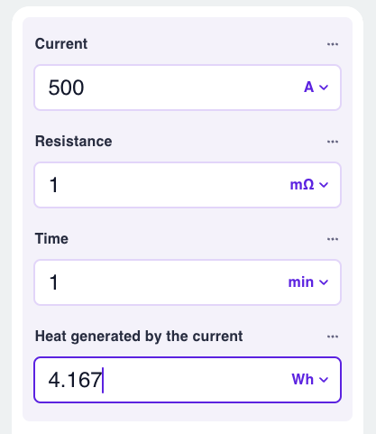

That’s (potential) heat generated by a 500A fault over a 1 milli-ohm conductor every minute. Essentially, you would want your conductors to be in the 10’s of micro-ohms for safety.

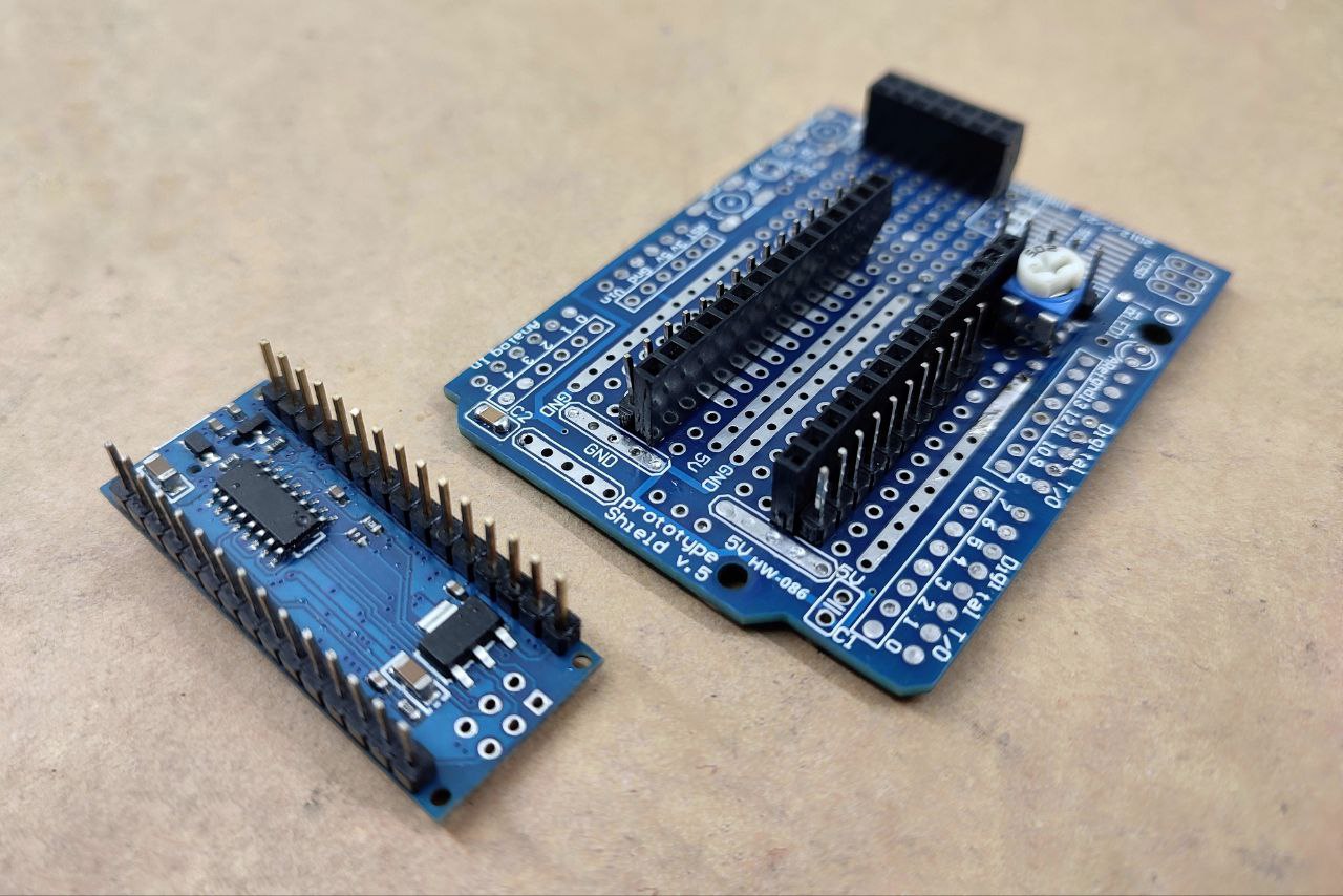

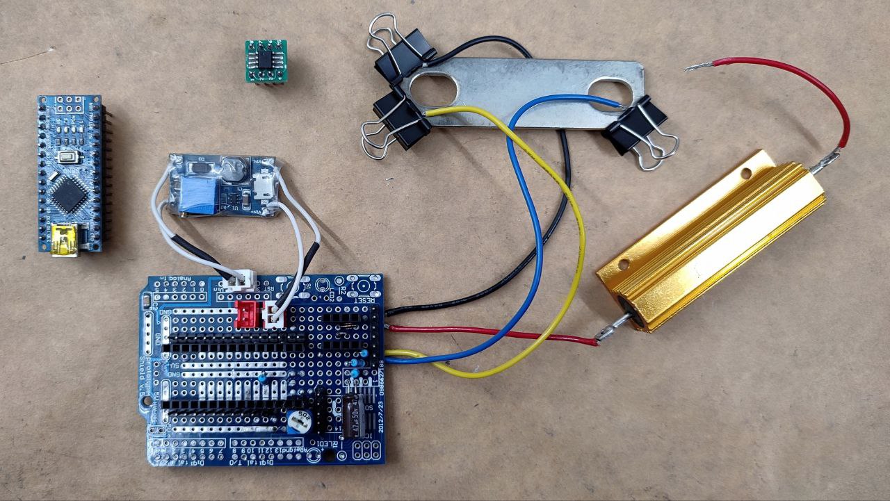

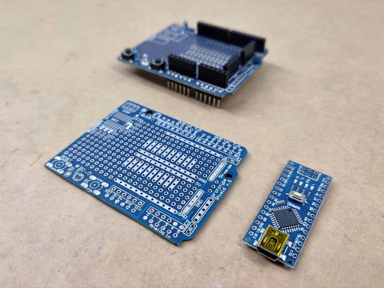

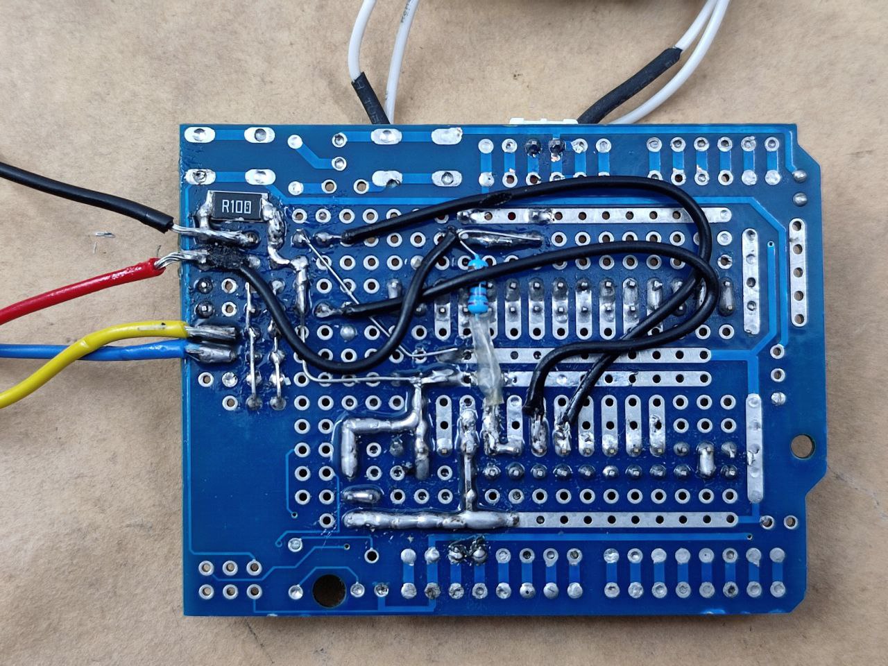

Starting with depopulating a popular prototyping board for Arduino, to serve as the carrier PCB for an Arduino Nano:
Attached headers and a trimpot to adjust contrast for a LCD:
Also seen above is a 0.1uF decoupling capacitor in the bottom left of the proto pcb.

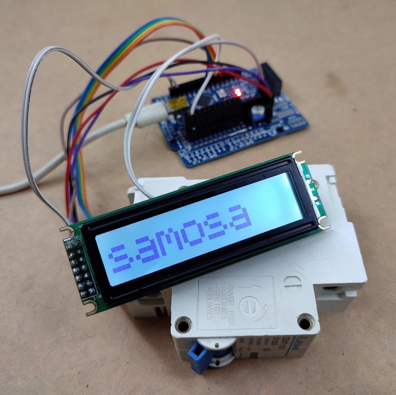

First test with the JHD 8x1 LCD, naturally:
Vollrathd’s design incorporated a very cool but tiny OLED — I wanted a larger, easier to read display.

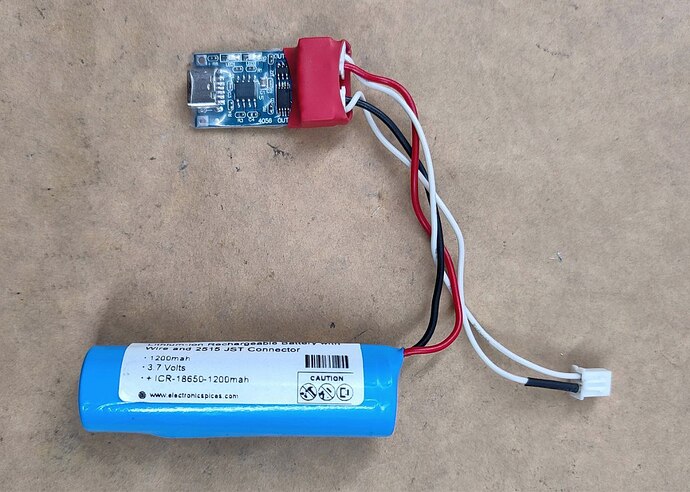

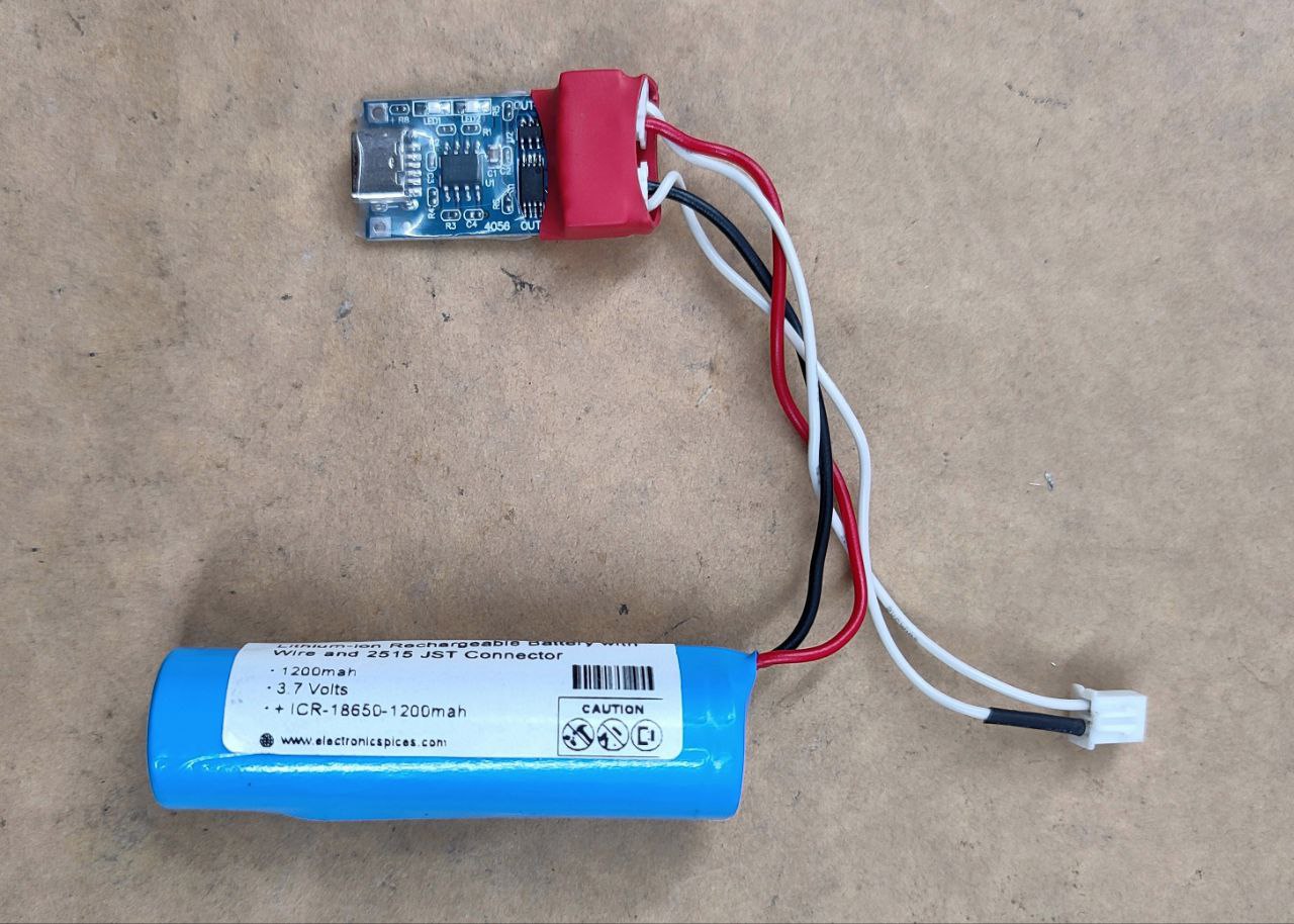

Power is with a 1.2Ah 18650 cell, with a TP4056 module serving as a charger & low voltage disconnect:
Vollrathd’s design has a 2S pack for a higher voltage that’ll push >1A through the conductor-under-test. A single cell like this pushes about half that much (through a 5 Ohm power resistor):
A little boost converter provides 5V for the Arduino and the 18-bit Analogue to Digital Converter, a MCP3422. The other components are two zeners, three resistors and a capacitor for the input protection of the ADC. There are two more resistors arranged as a voltage divider for the Arduino to measure and display the battery voltage (details in a later post).

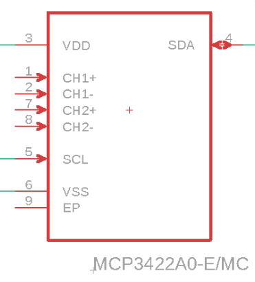

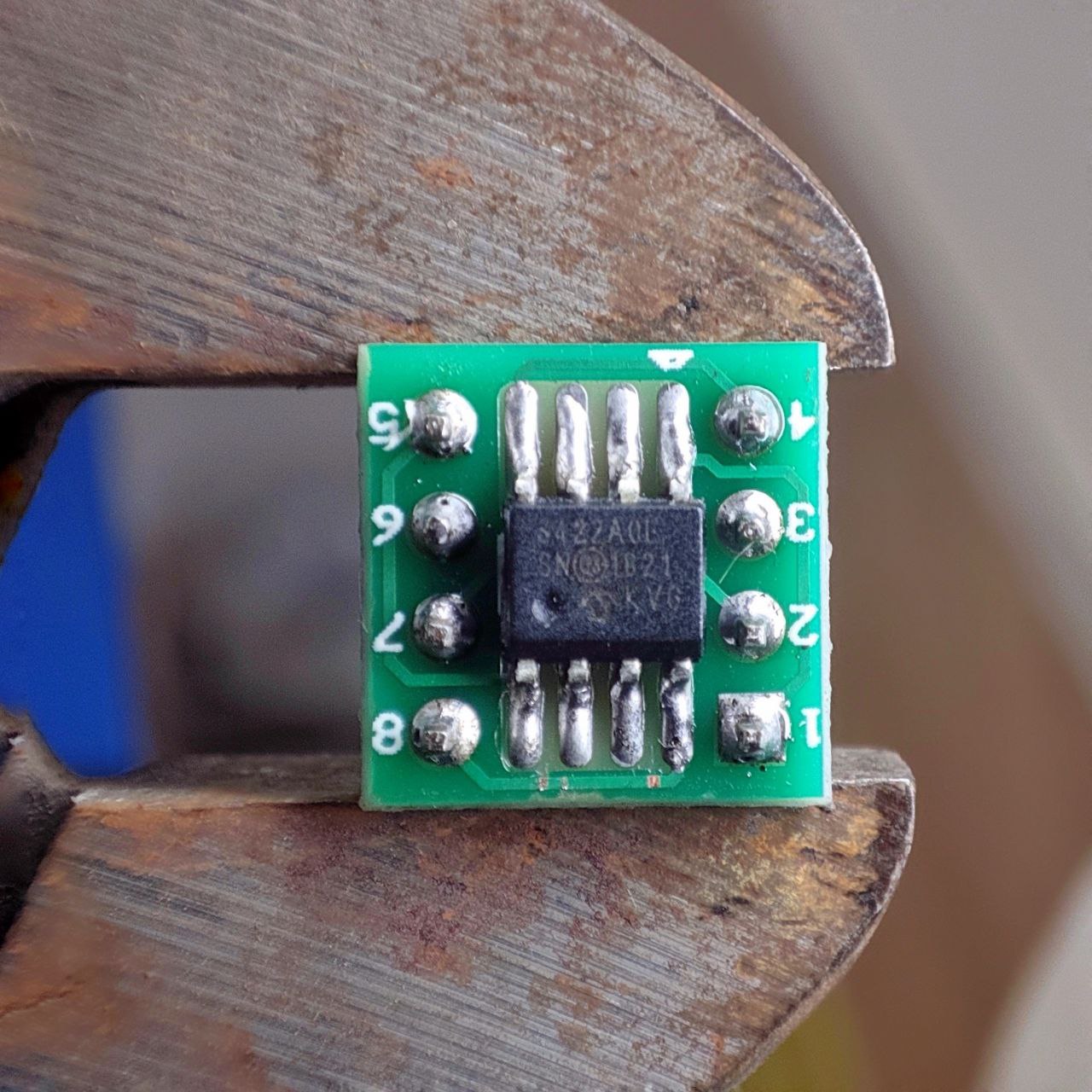

There are only two ways to put this chip on this adapter PCB, so it’s not a surprise that I got it wrong (white mark on the top right indicates pin 1, but pin 1 is in the bottom left).

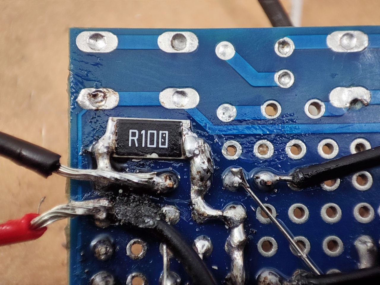

In other news, I seem to have lost my soldering mojo, this is definitely not [my best work](’

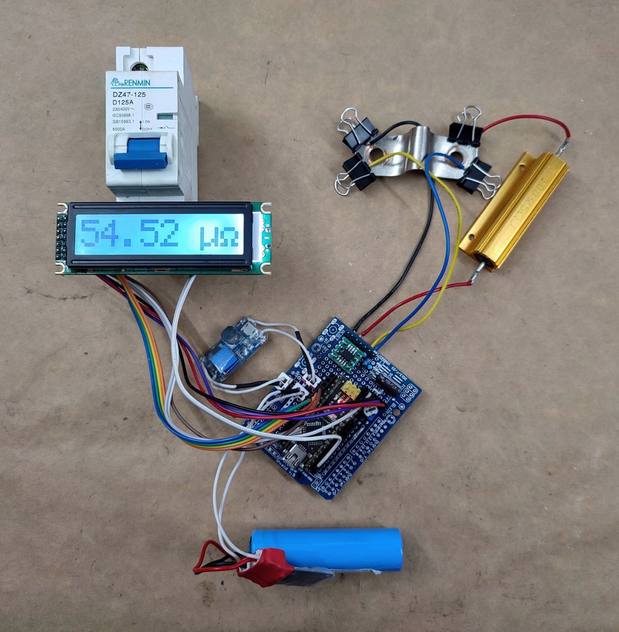

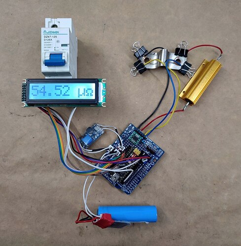

I’m still waiting on the kelvin probes to be delivered (they allow four-terminal sensing:
) but here’s a quick test:
That’s 0.05 milli-ohms or ~50 micro-ohms across the bus bar that was installed in [the Muscle Grid battery](’
Teardown & Rebuild of a MuscleGrid LiFePO4 Server Rack Battery - PC Builds, Modding & Overclocking - TechEnclave
). Cross-sectional area of it would be 20 sq mm (20 x 1mm).

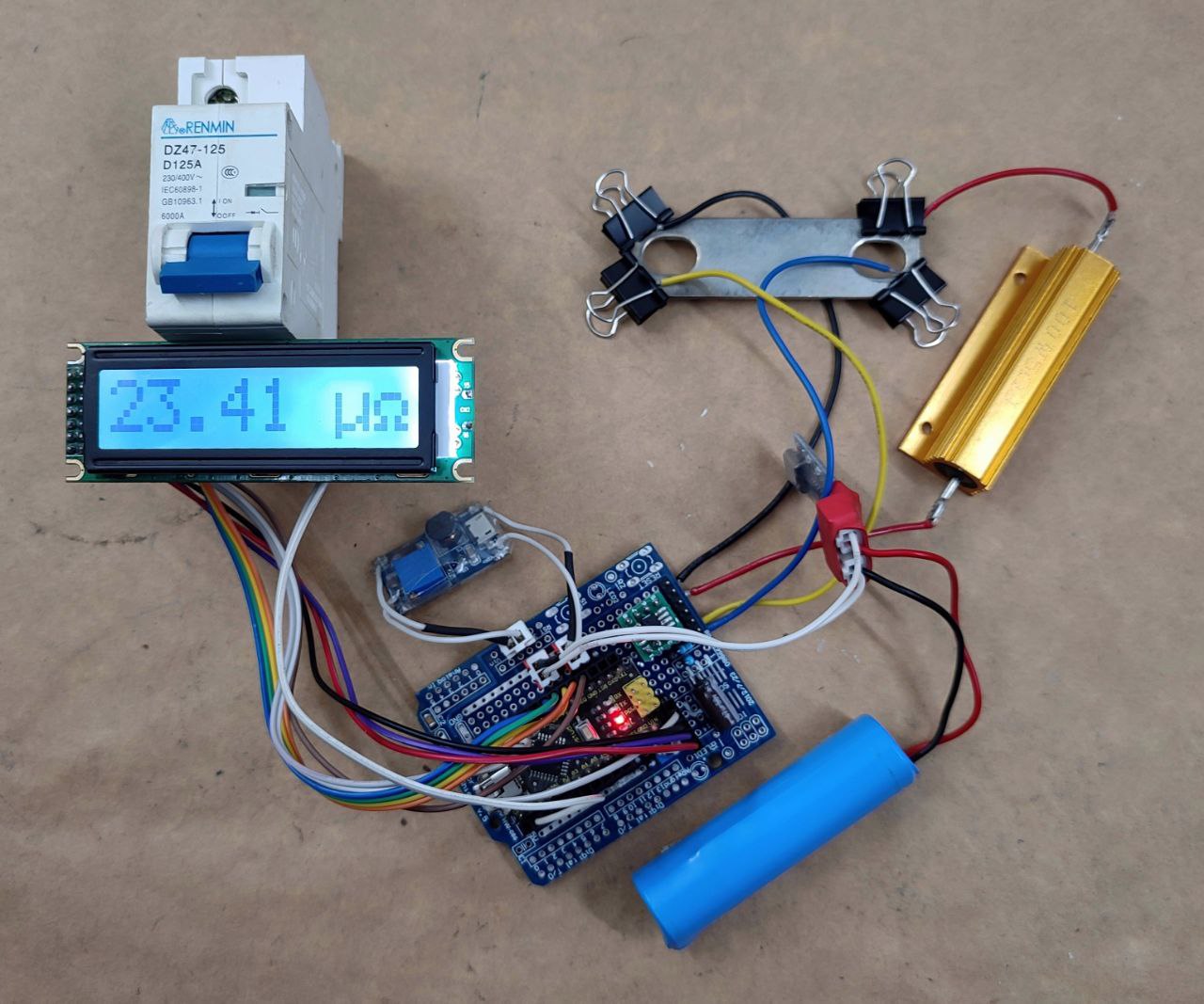

Compare that with this 40 sq mm bus bar (20 x 2mm):
Working as expected, the meter shows about half the resistance at 0.02 milli-ohms or ~20 micro-ohms. Schematic and code to follow.

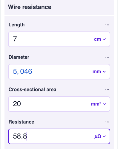

edit: comparing to the calculated resistance of a somewhat ideal conductor without holes, the uncalibrated reading is within 5 micro-ohms:

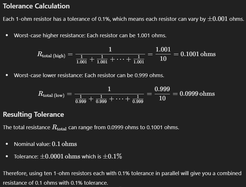

Finding a** 0.1Ω 0.1%** resistor is hard and also very expensive, however you can get 1Ω 0.1% resistor and if you put 10 of those in parallel you get 0.1Ω resistance with 0.1% tolerance.
This is the part number RT1206BRD071RL, 10 of those will cost you around ₹600.
The second benefit of this if you pass 1A through that single 0.1Ω resistor, that resistor will dissipate 100mW as it will heat up, which will make it’s 0.1Ω value drift with temperature. But with multiple 1Ω resistors in parallel, 100mW will spread among them, so each resistor will dissipate only 10mW and they won’t drift as much.

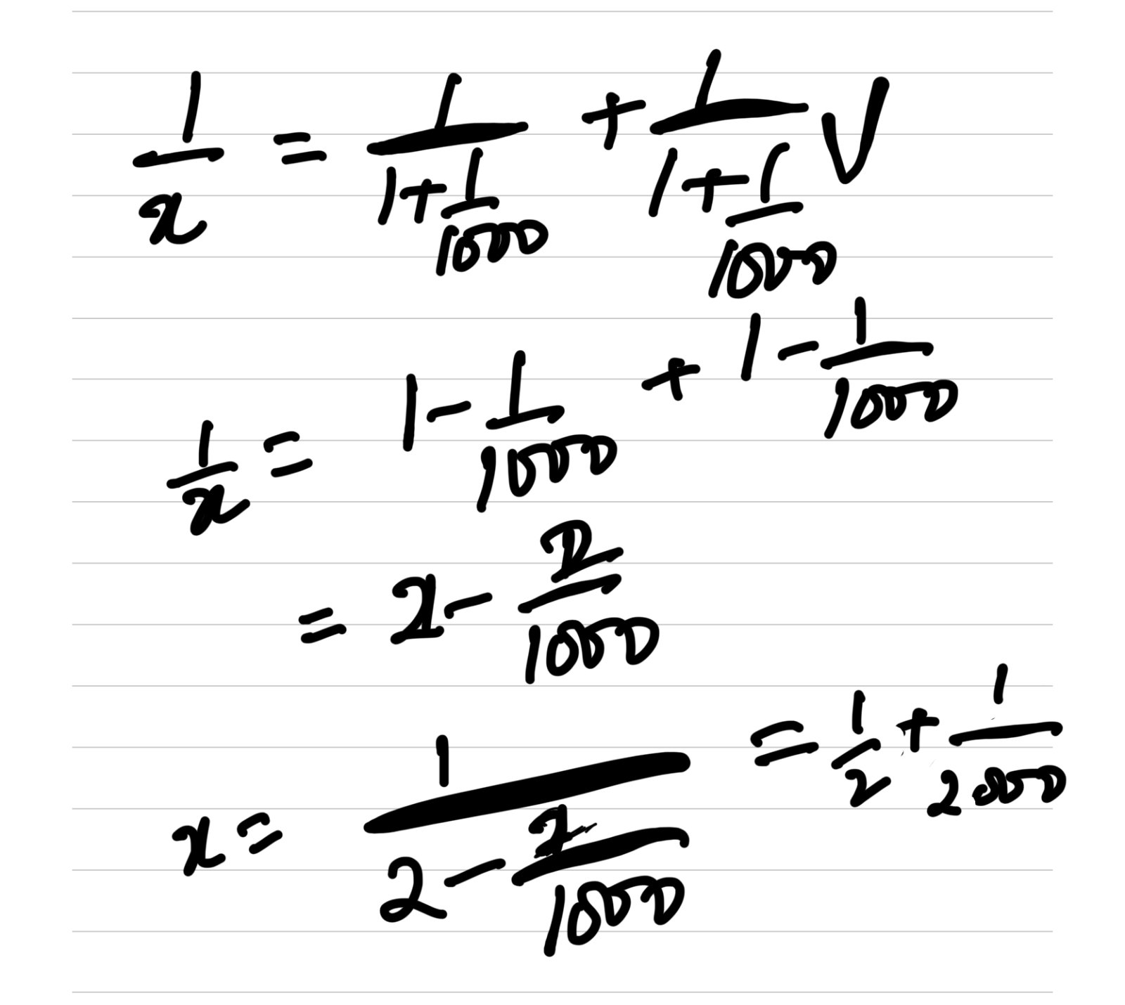

The tolerance will be 10 * 0.1% not 0.1%.
I did a few quick searches and found that tolerance of resistors, whether in parallel or series, will be the same if they’re all the same (it gets complicated if you’re mixing different tolerances).
It makes sense, if you have two 100 ohm resistors that have hypothetically 50% tolerance, then you’ll have effective resistance between 25 ohms (two 50 ohm resistors in parallel) and 75 Ohms (two 150 ohms in parallel) — that range of 25 to 75 is basically a 50 ohm resistor with 50% tolerance.
The power dissipation will be distributed equally with multiple parallel resistors, so there’s that plus point.
This micro-ohm meter should be used for a few seconds at a time to prevent any drift. Maybe I can wire in a relay somewhere to cut off current after 5 seconds but have the display remain active. Then I’ll need a button to resume measurement — or just reset the Arduino.
I found 0.1% 750mW four-point current sense resistors under Rs 70 on element14. Just need to to get a GST number and buy 1000 of them, ha.
I am SO excited for this. The original nano died during botched programming and a few digital pins on the other nano died because I was swapping connections while the nano was powered on. I looked it up and these digital pins don’t like being driven directly to ground or 5V when they’ve already been assigned as output pins (sounds obvious in hindsight). I haven’t had any issues other than that.
I think chat-gpt is correct.

I
I did the correct calculation but didn’t divide by the new value to get the percentage. You & chat GPT are correct.

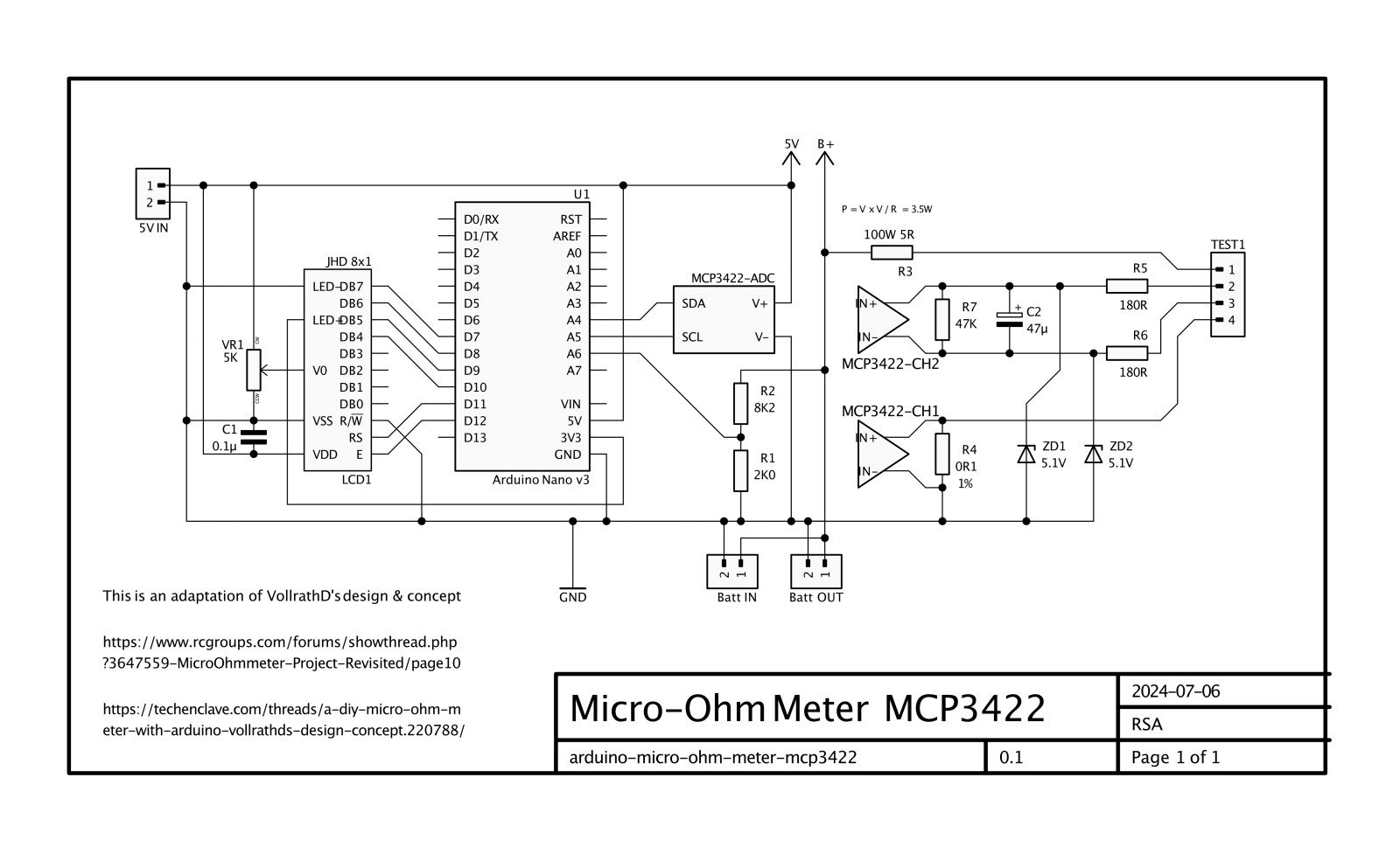

Hey look it’s my first schematic! Lot’s of firsts happening these days, ha. It’s not very good but hopefully, it’s clear enough.
[HR][/HR]
Some notes:
This is powered by a 18650 Lithium-Ion cell
The cell is plugged into a TP4056 module which handles charging and low-voltage disconnect.
The output of the TP4056 module is then plugged into the proto pcb.
The proto pcb then distributes the battery voltage to the voltage divider R1 & R2, the power resistor R3 and out to a MT3608 boost converter module.
The boost converter module sends back 5V to the proto pcb.
It’s done this way because of what modules I had available, there are easier and better ways to do this.
[HR][/HR]
Some other notes:
The voltage divider steps down the 4.2V of a fully charged cell to 0.84V for the Arduino’s ADC that’s using its internal 1.1V voltage reference.

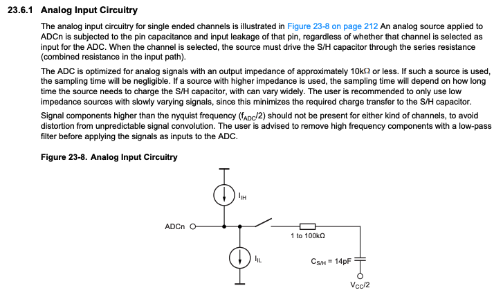

It’s been stated by Arduino engineers that you should keep the input impedance of analog inputs to 10K, which is why chose 8.2K and 2K.
In the code, the ADC reading is remapped to output a number that’ll match the voltage at the divider — a reading of 840 for 840 millivolts or 0.84 volts. That reading can then be simply multiplied by 5 to get the actual voltage. In reality though, due to tolerances and inaccuracies, the multiplier will be either a little higher or lower than expected.
Low voltage disconnect is at 2.5V so the analog pin will read between ~490 and ~823 for the voltage range of 2.5V to 4.2V. If I had used a 10:1 voltage divider, like Vollrathd’s original 10k and 1k resistor, then that range would’ve been much smaller at between ~227 and ~381. In the end, none of this actually matters so long as the voltage calculated is close enough to what the actual battery voltage is.
The purpose of the battery reading is to let you know when the cell needs to be recharged (though the low voltage disconnect would probably do that for you, making this entire portion redundant, ha).

Looks great for the first timer.

The MCP3422 is divided in 3 three sections which becomes little bit hard to read, from the first glance it looks like three MCP3422 is used, if you look at the arduino nano and the LCD1 both have all their pins together, similarly you can make the MCP3422 like that.

Hmmn, interesting I didn’t know that. Considering the amount of arduino circuits I have seen, people use very high value resistor voltage dividers (to avoid draining the battery). Googling further I found that for ADC the input impedance only matters when we have to measure a fast changing input signal. Since we are measuring a static signal here which is basically a battery voltage, which changes very slowly over time, we don’t need to worry about this. You can use much higher value resistors.
Also calculating input impedance for ADC input is not that simple, based on your 8.2k and 2k voltage divider, the input impedance is 1.6k. Based on this formula Zin=(R1+R2)/(R1×R2).
The TP4056 will probably disconnect at 2.5V which is very very low, you probably should disconnect at 3.0V. So it is not redundant.
Yeah, it would not have been my preference or choice, but that’s what was available with this schematic software, LibrePCB on a mac. It took a few hours of learning the quirks of the software and I think now I like it. They do have a way to make custom symbols but I need to learn more about that, it wasn’t intuitive. There’s something about KiCad that I really don’t like, probably because it’s now mainstream. Or maybe because it does a lot of things?
Thanks, I tried to mimic the schematics I remember in Elektor Electronics magazines back when I was a teenager and I tried really hard to avoid what I didn’t like about the schematics in Electronics For You magazines of the same era. Then I watched a couple of videos about “top design mistakes in schematics” or something and did it all over again — mostly making sure all text reads left to right.
I have made a PCB before with OsmondPCB on mac, but that was without a schematic:
I’m probably making things difficult for me by using a mac. I like to work slow, I guess.
Thanks for this, I never actually needed to calculate that before — but it’s good to know now.
I followed on through to the datasheet for the 328P:
Further reading about what this could mean:
https://electronics.stackexchange.com/questions/107741/required-output-impedance-for-adc-input/107755#107755
That is true, if this was a critical reading I’d just use a INA219 since it’s a far more elegant solution. Prolonging battery life is less of a concern here, since this’ll just be used for a few seconds at a time to check connections. I did notice however that the battery voltage fell drastically after 3V —
— so this makes sense.
I’m already designing a PCB in my head for this, but I need to pace myself and not rush into it. I tend to get hyper-focussed on a single thing and forget about the rest of the world. This circuit works, so now I’ll stuff it in a food container and continue with the other projects and revisit this later and possibly make it into a product.

      calc_4x16bit();
    if (!conductor)
      calc_2x14bit();
    if (!conductor)
      calc_1x12bit();
    if (conductor < 0)
      conductor = conductor * -1; // convert to positive if negative (shorted probes)
    //Serial.print(conductor);
    if (conductor >= 2)
      lcd.print("OL1.999\xF4"); // overlimit
    else if (conductor >= 1) // auto-range below for 8x1 display
      lcd.print(conductor, 4); // 1.0000 to 1.999 ohms
      lcd.print(" \xF4");
    else if (conductor * 1000 >= 100)
      lcd.print(conductor * 1000, 1); // 100.0 to 999.9 milli-ohms
      lcd.print(" m\xF4");
    else if (conductor * 1000 >= 10)
      lcd.print(conductor * 1000, 2); // 10.00 to 99.99 milli-ohms
    else if (conductor * 1000 >= 1)
      lcd.print(conductor * 1000, 3); // 1.000 to 9.999 milli-ohms
    else if (conductor * 1000000 >= 100)
      lcd.print(conductor * 1000000, 1); // 100.0 to 999.9 micro-ohms
      lcd.print(" \xE4\xF4");
    else if (conductor * 1000000 >= 10)
      lcd.print(conductor * 1000000, 2); // 10.00 to 99.99 micro-ohms
    else
      lcd.print(conductor * 1000000, 3); // 1.000 to 9.999 micro-ohms
    conductor = 0; // reset for next run
  else // if no test conductor is connected
    lcd.print("b: " + String(battery_volts) + "v");
  delay(1000);
