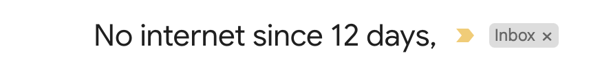

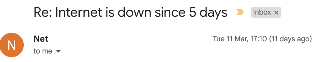

FYI. below how effectively they work even after the escalation.
