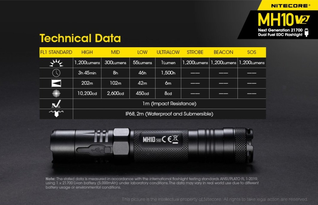

Let me show you a torch that has a decent runtime. How much it costs. What the manufacturer says and what it really puts out.
[Price](’
Nitecore MH10 V2 - USB-C Rechargeable EDC Flashlight, 1200 Lumens, Nitecore MH10 V2 in India at Lightorati
[Review](’
Review: Nitecore MH10V2 (XP-L2, 1x21700, USB-C) - 21700 Flashlights - BudgetLightForum.com
Weight is around 150gm with battery

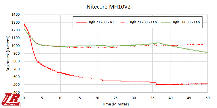

3h45 on high at 1,200 lumens reaching 200m
What it really puts out?
High doesn’t last long. Within 5 minutes it drops to 700 lumens and after 40 minutes drops to 500 lumens at room temperature.
If you cool it with a fan it holds the brightness longer but that is not practical.
This torch with a 4,000 mah battery will last 3.5h but with an output of around 500 lumens.
So you can see how the brightness curve is like in real life
The part that matters is it holds at that brightness for 3.5h. Is that bright enough? Long enough? Far enough? Those are the parameters you need to figure out
How bright for long is down to how big the battery is. This one is a 21700 cell of 4,100 mah. Cells are available. Lasts longer than the more common 18650
This torch is around five years old but can deliver decent output for enough time.

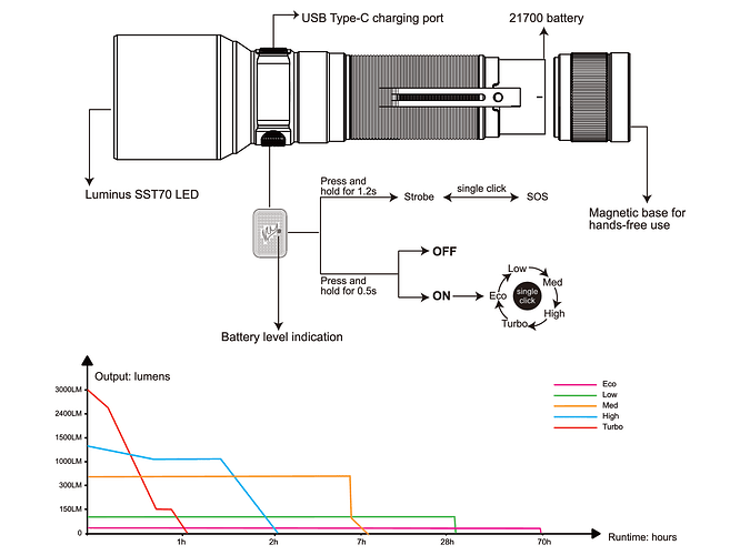

Weight is 244gm with battery

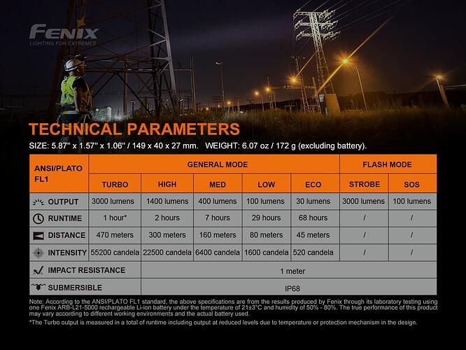

Fenix makes it easier to see what you get as they provide performance graphs which Nitecore does not
What they state
What you get
You can compare the graphs with the review. But you can see the performance is better. Fenix manages to pack 5,000mah into their 2100 cells. Also the throw is 300m for brighter.
In reality, halve the distance to 150m and it will look like it’s illuminated with a car light.

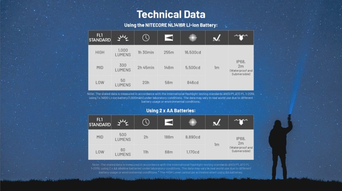

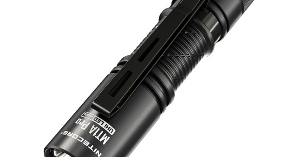

Always been curious at how effective torches can be at deterring strays. Thai bro shows just how

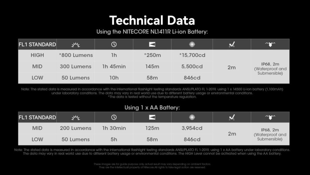

He hits them with the full 800 lumens. What matters more in this case is the candelas it puts out. At 800 lumens this torch puts out 15,700 candelas or about 20 candelas/lumen
Has two options. 14500 lithiums have the same form factor as AA but are more powerful
Since it’s small the runtime and range will be less. And you don’t get any high beam with AA batteries
If that’s not enough there’s a 2xAA model for not much more
Range is further
2xAA and lithium
Fnd a review to know just how long at how bright
