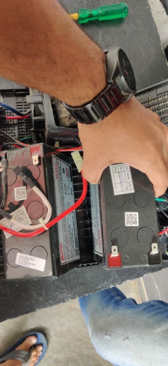

Thank you for your inputs. I got the 2 batteries replaced today but it was actually 7Ah battery only for 1000/- each in my APC 1100va UPS after exchange with old ones.
Shocking part is this UPS I bought is from a local computer store market area famous in our city back in 2021 and just today it to learn that it’s original Batteries are from 2013 :open_mouth:
