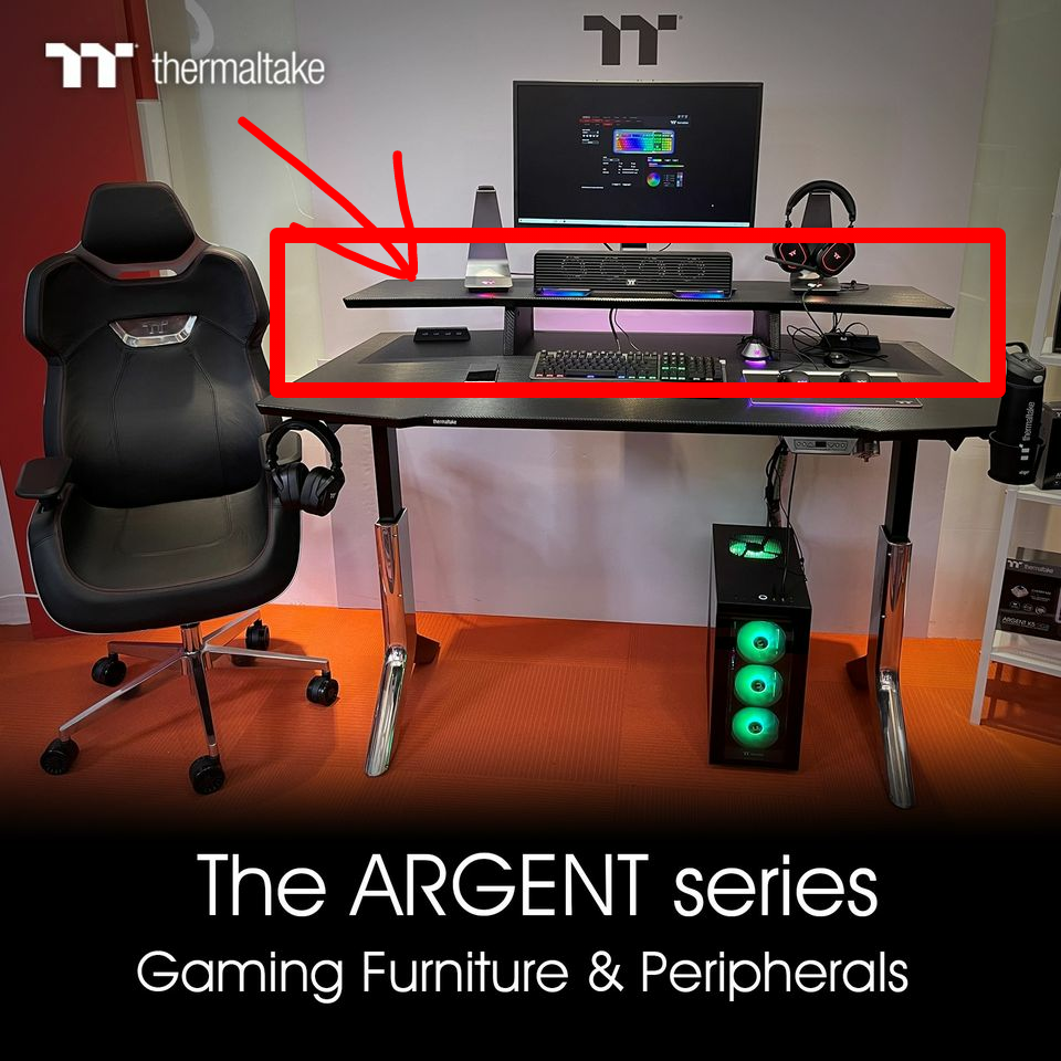

Btw I’ve been wanting to know something about a particular new “design” of pc tables. What does this shelf help with? What’s it’s purpose and benefits? Is the monitor height good? If I remember correctly this design was trended by IKEA.

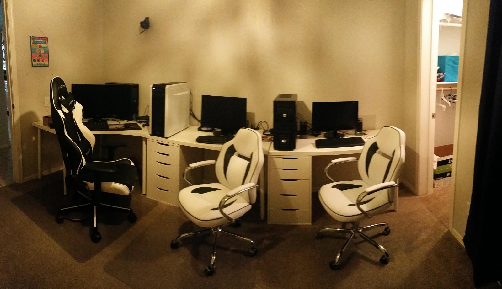

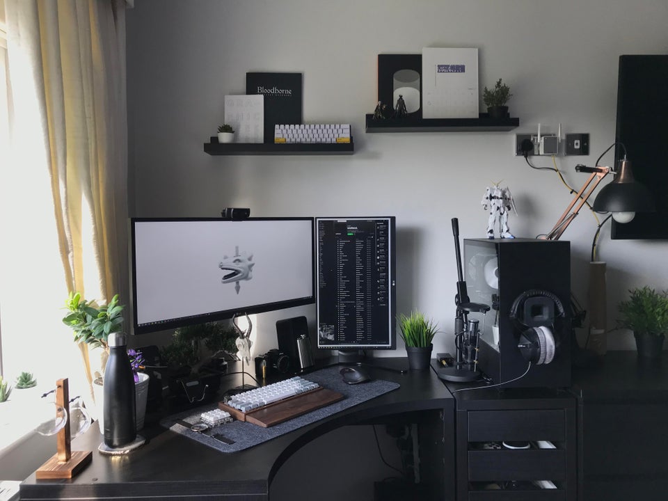

  1. The “curved” design in V or L shape and to be placed at the diagonal corner of the room. With some drawers on the side as shown in the pic.
  2. The drawer/racks on the table. They are really neat.

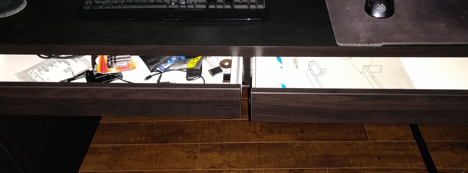

  3. Proper drawer underneath the table
  4. Or drawers like this

It’s for maximizing usable area as it’s evident in the pic itself, if all the items were on the same level the desk would’ve been quite cluttered.
Quite useful if you stream and use 2 monitors, all the extra room can be used to place audio interface, mic, stream deck, camera, etc comfortably.
As for the monitor height, it should ideally be at eye level, which is easily manageable with height adjustable tables and chairs as shown in pic.

it depends in what area or room you are placing and whether it will remain there for the rest of its life , if in corner than go for L shape design ,have drawers to keep those usbs and accessories that you usually dont use .regarding placing monitor you have option of wall mount ,use default monitor stand ,a stepped table as shown in the Pic and the multi monitor vesa mount stand ,if i were in your place go for the multi monitor stand which would provide good flexibility . even if you are not going with vesa mount approach ,make sure that tables top / or the table frame allows the vesa mount stand to be used in future.
regarding the electricals ,if you don’t have any drawer underneath the table than you can put a small shelf between rear legs of the table (make sure that your knees dont touch the shelf) use good surge protector and if possible use 2 of it ,as you would be charging your mobiles laptop connecting monitors accessories on etc. these would just keep things hidden.
If your printer has wi-fi than don`t place it at computer table ,it just sits and occupies space ,place your modem & Printer on some floating shelf if thats feasible .

To have maximum flexibility, i think a large flat table works best. Even most pc builders use a lot of IKEA products like the linnmonn tables for their setups that look clean and give enough space to hold everything, while also allowing you to fix things like cable management peripherals to the under side to give a clean look to your setup. If you are getting your table made through a carpenter, would recommend using size dimensions from the ikea table (while keeping the space you have in your room in mind of course) and add stuff like cable channels, headset hangers or cup holders according to your foreseeable need. Another option is to just buy a simple 4 seater rectangular dining table (without the chairs) and then mod it according to your use. That will also give you enough width and depth to put different things of your setup and still have room to work on it.
