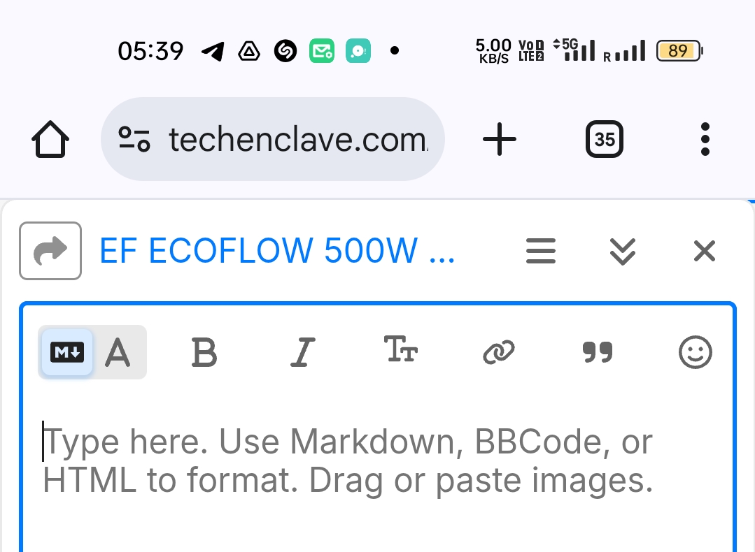

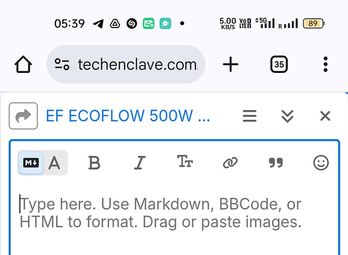

Even my connection is bad. Ghanta ka 5G.
I was wondering since past few days why YouTube is not playing videos smoothly.
