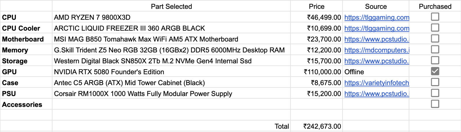

Hey everyone,
So I finally saved up money from my first job to build my dream PC. I’ve only ever owned a hand-me-down gaming laptop and a PS5, so I’m very excited (and nervous) to build this :grinning_face_with_smiling_eyes:
I managed to grab an RTX 5080 FE at MSRP which is what prompted this whole build.
I’ve done a fair bit of research but before I pull the trigger, could you guys help me sanity check if everything looks okay? I wanna be sure that I am not wasting unnecessary money somewhere and I’m willing to spend a little more if it gets me better performance/reliability.
I’m also a bit unsure about the motherboard, these are two other options which are priced similarly:
  1. GIGABYTE B850 Aorus Elite Wifi7 DDR5
  2. Msi Pro B850-P WiFi AM5 ATX
Thank you!
Primary Use Case: Gaming (Cyberpunk 2077, Alan Wake 2, Black Myth Wukong, Forza Horizon 5 etc.)
Target Resolution and Refresh Rate: 4K @ 120Hz (LG C4 42")
I feel like this is a very solid build already, I was looking to do a similar build for a friend so i have some opinions:
I would instead go with 2TB x 2 SN770 (or something similar or cheaper) drives instead of the SN850x x 1 simply because games (especially the ones you pointed out) are all 100GB+ games.. and since you are not doing any productivity work, I don’t think you will see a difference going with the SN850x.. Could also go 1TB SN850 and 2TB SN570 or 770.
For the motherboard i would go with a x870 at a 24kish budget.. you should be able to buy a X870 Gaming plus from MSI or Asrock boards for that money. However my personal preference would have been to buy the cheapest full atx board with a pciegen 5 x16 slot and 3 m2 slots with wifi.. i believe boards like these should be available under 20kish.
I would have gone with the non-rgb version of the A LF 3 and saved some money there.
I would pick a case which does not require additional fans to cool the gpu better, for eg a Lancool 207 comes with all the fans you need and you just need to add the AIO.. if you are dead set on a 360 AIO and RGB i would instead go with the O11 vision compact + Deepcool LE360 V2 + 2 sets of UNI fans and make it a full on pretty build.. no half assed efforts.. either all black or full prettiness.
If you dont care about looks.. a AG620 cooler and Lancool 207 is cheap and will perform equally good.
You can easily save money by going with the Deepcool PN850M ATX 3.1 supply.. it comes with pre sleeved cables which look nice, its available for 9k and will handle your components just fine.. 1000Watts is quite overkill.
EDIT: also buy everything from 1 store to avoid shipping costs.
Great advice on the SSD, I’m definitely considering this.
Yeah so the reason I chose Antec C5 is because it comes pre-installed with 7 ARGB PWM fans which felt like a solid deal at this price. That combined with the ALF3 would give me an all-RGB setup.
I’ve gotten the advice regarding PSU from multiple people now, so I think I will make that change as well.
Thanks a lot this was really helpful :slight_smile:

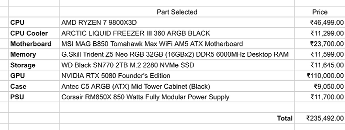

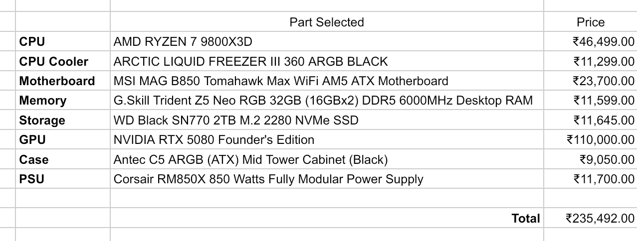

Specs? Price you paid for each part?
Here:
