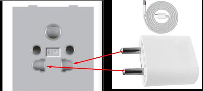

Reason: These days mobile charges are coming in 3 pin plug form factor but without third/earth pin. And all above series 3 pin sockets can’t accommodate them without circus.
This highly scientific diagram will make it all clear.
Chargers can’t be put into 2 pin socket because those holes are small.
Also we can’t use 2 pin socket like this for mobile chargers because these are so big that they overlap on the button next to this socket. Not to mention, chargers can’t open safety shutter in them.

Can you post a pic of these 3-pin mobile chargers without the 3rd pin?
If they’re Indian format plugs why is the missing 3rd pin a problem in that socket?
They shouldn’t be small
At some point, you’re going to have to get an extension cable. Preferably one with 3 pins which means it won’t go into that two-pin socket which is a good reason not to use them AT ALL and just stick to 3 pin sockets and be future-proofed for life.
All mobiles released in a last few years have chargers like that. Check the charger from the photo itself. Check your own charger against any other 2 pin plug.
One may not realise it but chargers don’t come with standard 2 pin plug layout. Chargers have bigger prongs like 3 pin plug and spacing between prongs is also like 3 pin plug.
Hence mobile charges require 3 pin socket but as they don’t have earth prong to push away the safety shutter, they get cockblocked.

I find such sockets in Schneider and Legrand. These have oval shaped holes. I want to know we can plug in a 2 pin plug in them without any problem right?

There are some discrepancies with 3 pin socket. Unlike the above photo the newer models come with round holes. And we can plug in most 2 pin plugs without problem. Some smaller 2 pin plugs will pose some problem though.
