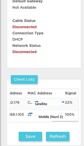

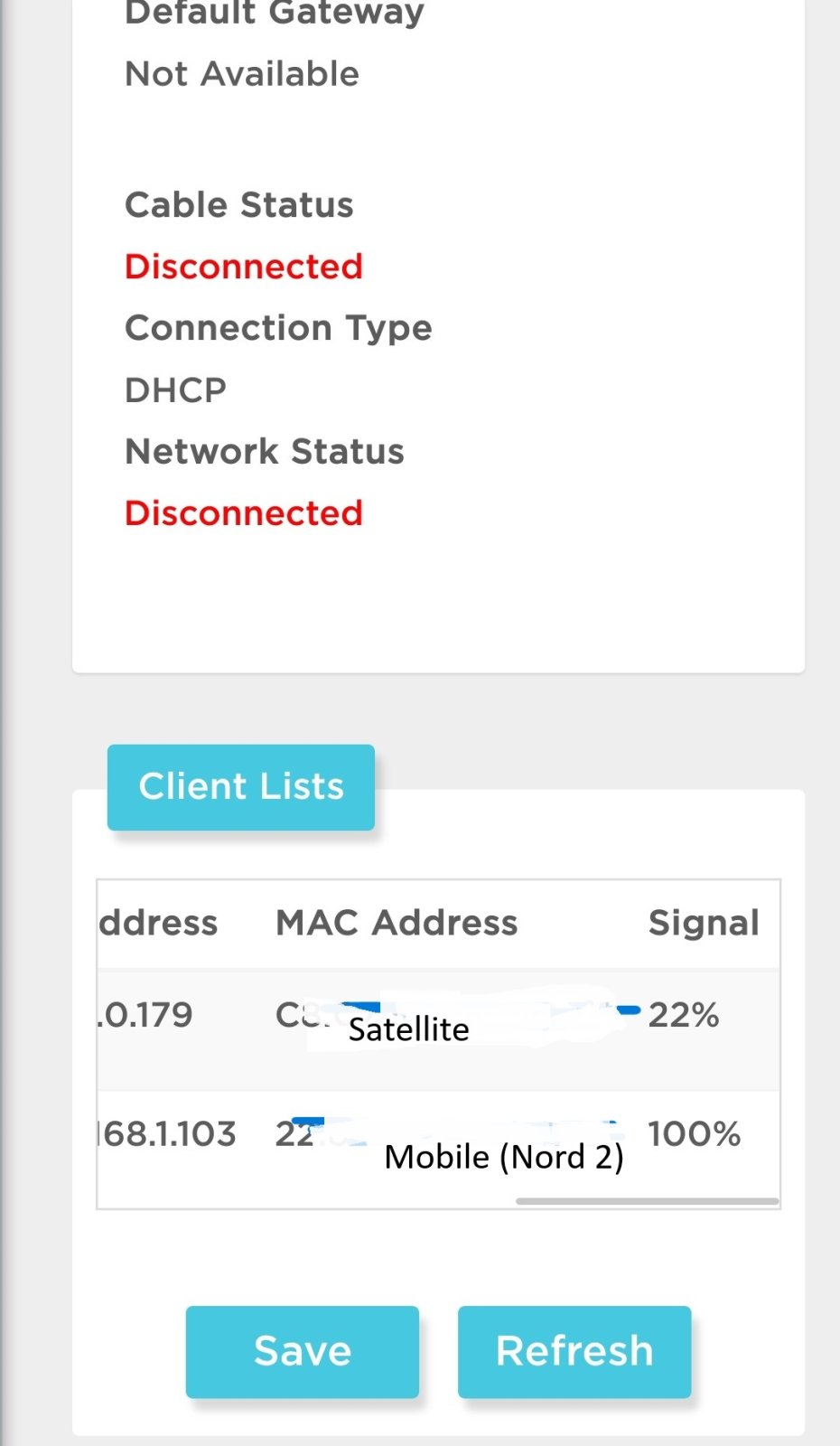

  • I plugged the router in one end and satellite in other end of the house. Did not connect any ethernet cable into the satellite. Bandwidth was ~30mb/s on fast.com, the main unit (router)'s status page showed 22% signal strength. The Satellite itself had blue light in the logo (indicating OK connection, not great).
    Screenshot taken on Nord 2, near Main Router.
  • When I plugged ethernet cable into LAN port of Satellite, logo went to green. Local speedtest ~550mb/s and ping ~9ms. (Ping similar to other WiFi I already had) Note that the main router needs to be in AP mode and both router and satellite must be plugged into switch with their LAN ports.

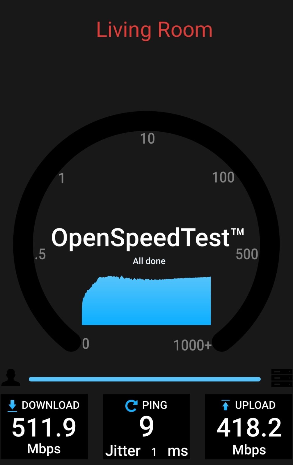

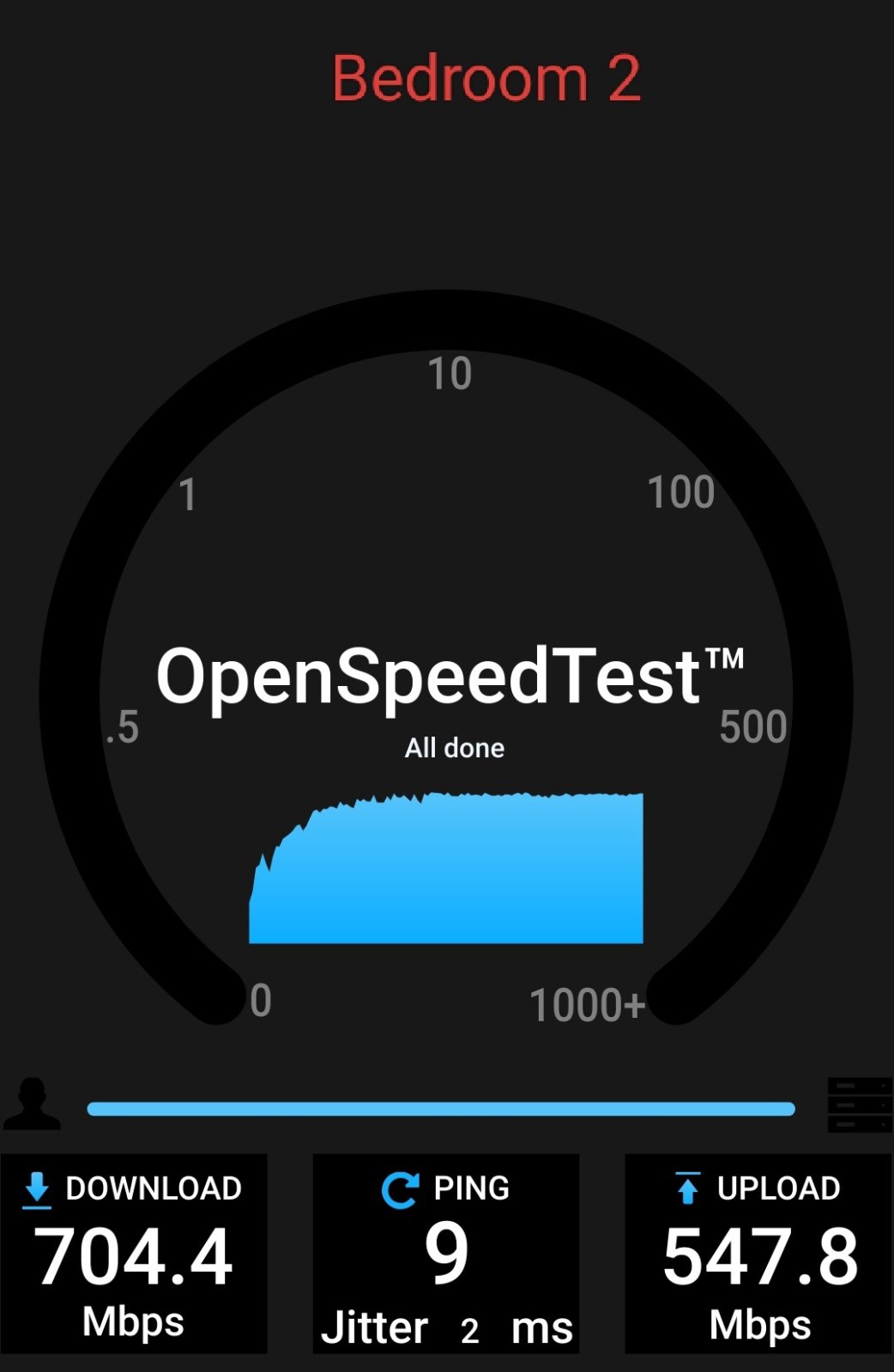

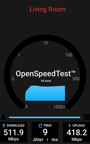

Didn’t understand what you meant by LAN and then WiFi. These don’t have LAN ports since I am using the only LAN port it had
In screenshots I attached, 4 and 5 are there. Bedroom 2 is next room, Living room is the farthest one.
I have 240mb/s internet, and all speed tests were local only (Openspeedtest running on my NAS).
Speedtest results on local host are almost as same as I got on Asus AC-68U (with respect to ping and bandwidth both).
fast.com speed tests maxed out the 240mb/s conenction near every satellite/router.
So You have a 240Mbps connection and are getting same speeds but Pics were showing 704 Mbps and 511 Mbps

Because those speed tests are with openspeedtest server running on my NAS.
There’s only one LAN port, and that connects to my main switch. Can’t connect another device to LAN. So LAN test between two devices on the Moto router isn’t possible with config I have.
Using a switch, connecting Moto device and another client to the switch, well it won’t go through the Moto Router when it is in AP mode.
Signal strength was 15-20% as seen on Moto dashboard. Speeds were 10mb/s. Don’t have a screenshot, but have tested this, and that’s why I know that wired backhaul was working.
