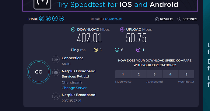

My motherboard is Asrock b650m pro rs, with 2.5Gbit ethernet. I’m using win 11 and I have been getting the best speed I could from my ISP plan.
It was fine a few days ago, I was getting almost 400 Mbps upload.
I have tried uninstalling drivers, changing ethernet cable, Changing ports on router, but now I can not get more than 50-60mbps upload.
I have tried everything from Microsoft posts to reddit but nothing works.
And yes I’m getting good upload on phone and laptop. Just having problem on this Pc.
