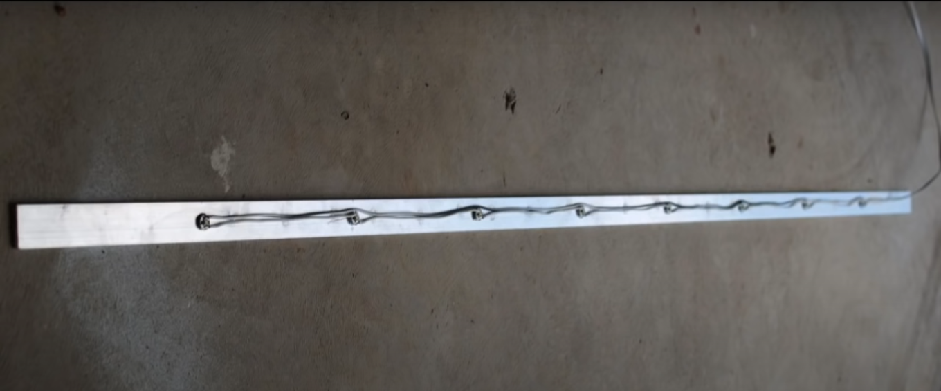

DIY - buy CREE high CRI leds from mouser, slap them on to a aluminum bar for heatsink, power it with a constant current driver. Face it up towards the ceiling to avoid glare. No idea how it will turn out, probably will need a lot of leds.

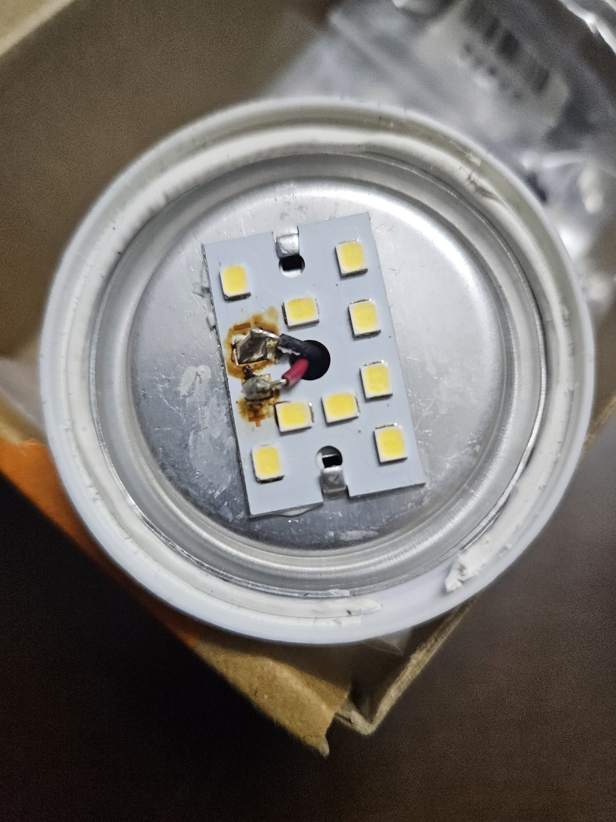

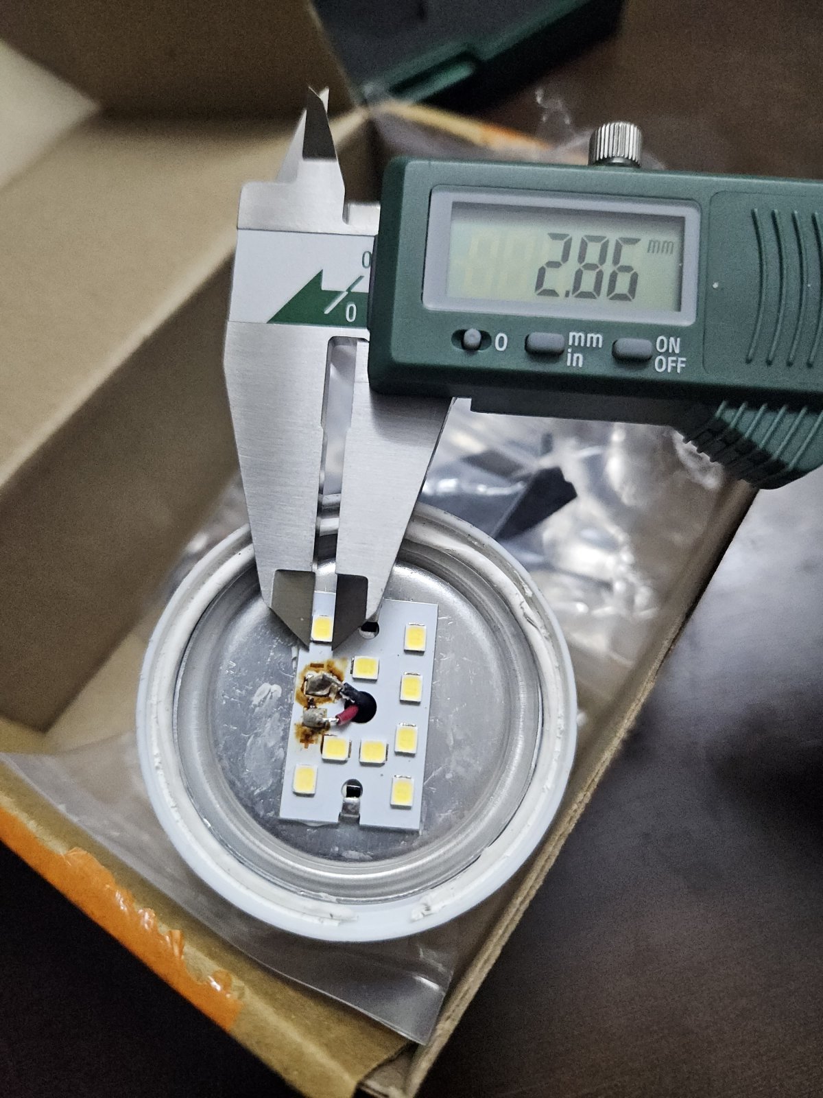

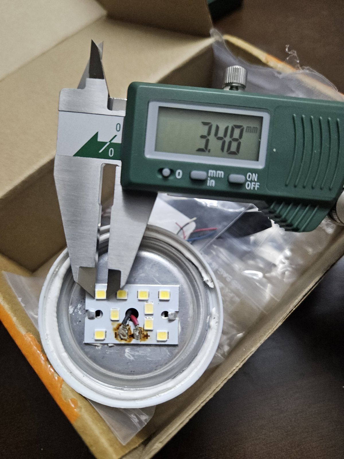

What I ended up doing, tore down one of my Philips 9w led bulbs, and found out they’re using 1w 2835 LEDs, with v_f of around 9v. Ordered 100x Bridgelux 97+ cri (Thrive series, ra, r1-r15 over 95) 2835 9v 1w 5000k leds from digikey. Should get them soon, will try to retrofit them in the bulb. If successful, gonna order more leds of different CCTs (digikey has them from 2700k to 5000k) and retrofit more powerful led bulbs, maybe even mix and match CCT.

Bonus, teardown photos and measurements of the bulb.

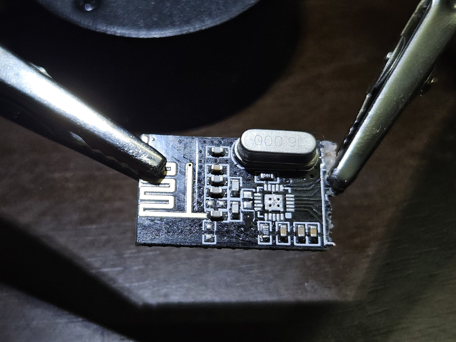

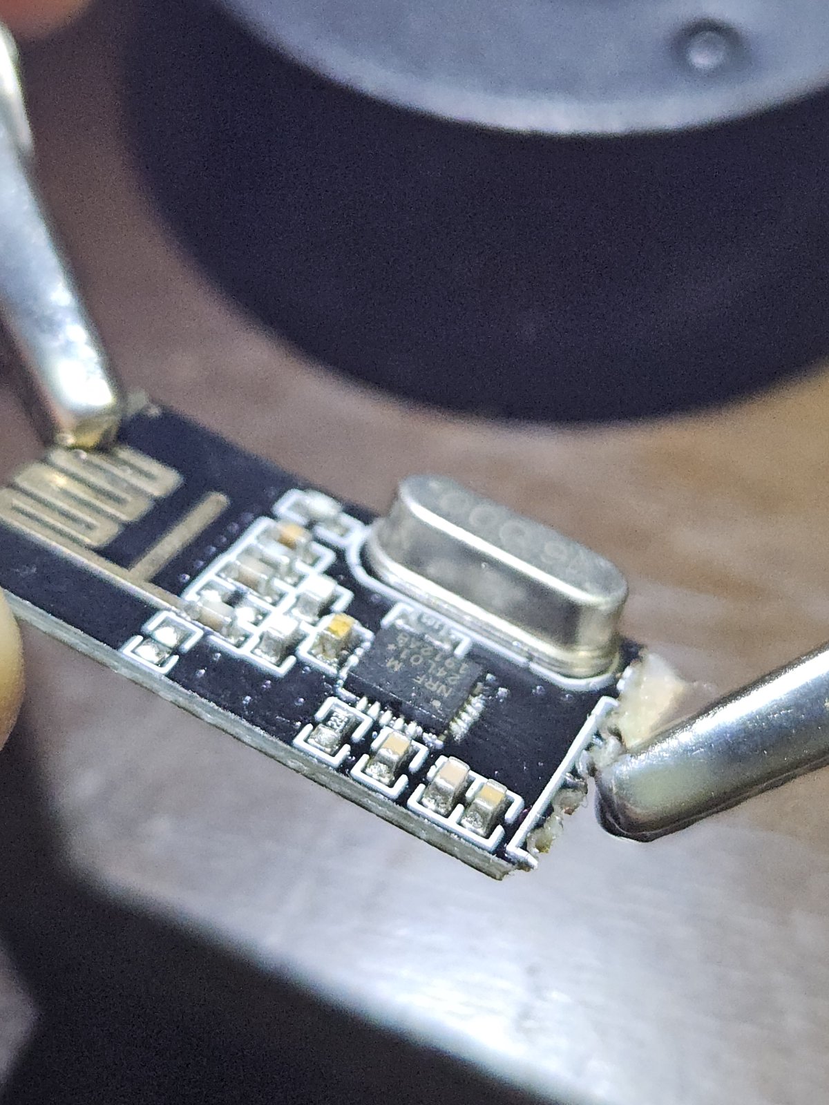

The hot air station arrived. Tried my hand at desoldering a qfn package, had a broken nrf24 board lying around. The desoldering went really well, removed the chip at 300c on the hot air gun, cleaned the pads with flux and desoldering wick.
Just for the heck of it, tried soldering the ic back, 3 sides turned out really good, one side has a solder bridge between 2 pins, too much solder paste probably. Good enough for first time, probably.
Which smd hot air station you bought?
Indeed, looks great. Solder bridges are easy remove with iron, I clean the iron with brass wool solder tip cleaner, and gently touch the bridge multiple times, repeating until the extra solder gets off.
Some cheap Yihua 882D, actually pulls 800w ish from the wall when using the hot air gun, not sure about temperature accuracy, but temp regulation looks fine.
