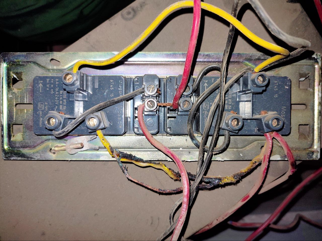

I’ve recently learned the dangerous/expensive way that the wiring in my parent’s house isn’t done properly — the wires are far too thin for the loads that they’re expected to carry.
Here you can see the electrician/builder daisy chained two 16A sockets with a yellow wire that’s ridiculously under-spec. And these two 16A sockets are further connected to another two 16A sockets in another switch box.
Basically a single 2.5 sq mm wire supplies power to four 16A sockets. In all my life, I’ve never wished ill upon anyone until this moment, and I will continue to curse whoever is responsible for this unforgivable insanity.
The proper way to fix it is to redo the internal wiring with suitably rated wire but that’s an expense and time sink that I cannot commit to anytime soon.

Your power bill will also increase due to this. If wire is getting hot, extra power loss is happening.

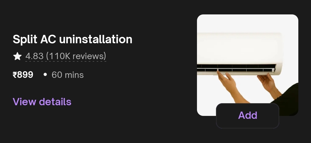

I used the exact same service last december. My case was extremely easy, though. Reinstallation is more expensive than uninstallation.
Here uninstalling and reinstalling with jet service costs 2500-3000.

The wire while being underspec , the distance is short between the 2 connections . The issue is with the contacts at the terminals where the wire cannot be tightened since they are multistrand .
One way is to use a single strand copper wire with 4 sq.mm or use multi strand with copper lugs and crimps . The lugs can be tightened properly and the rated current can pass through with least resistance .
