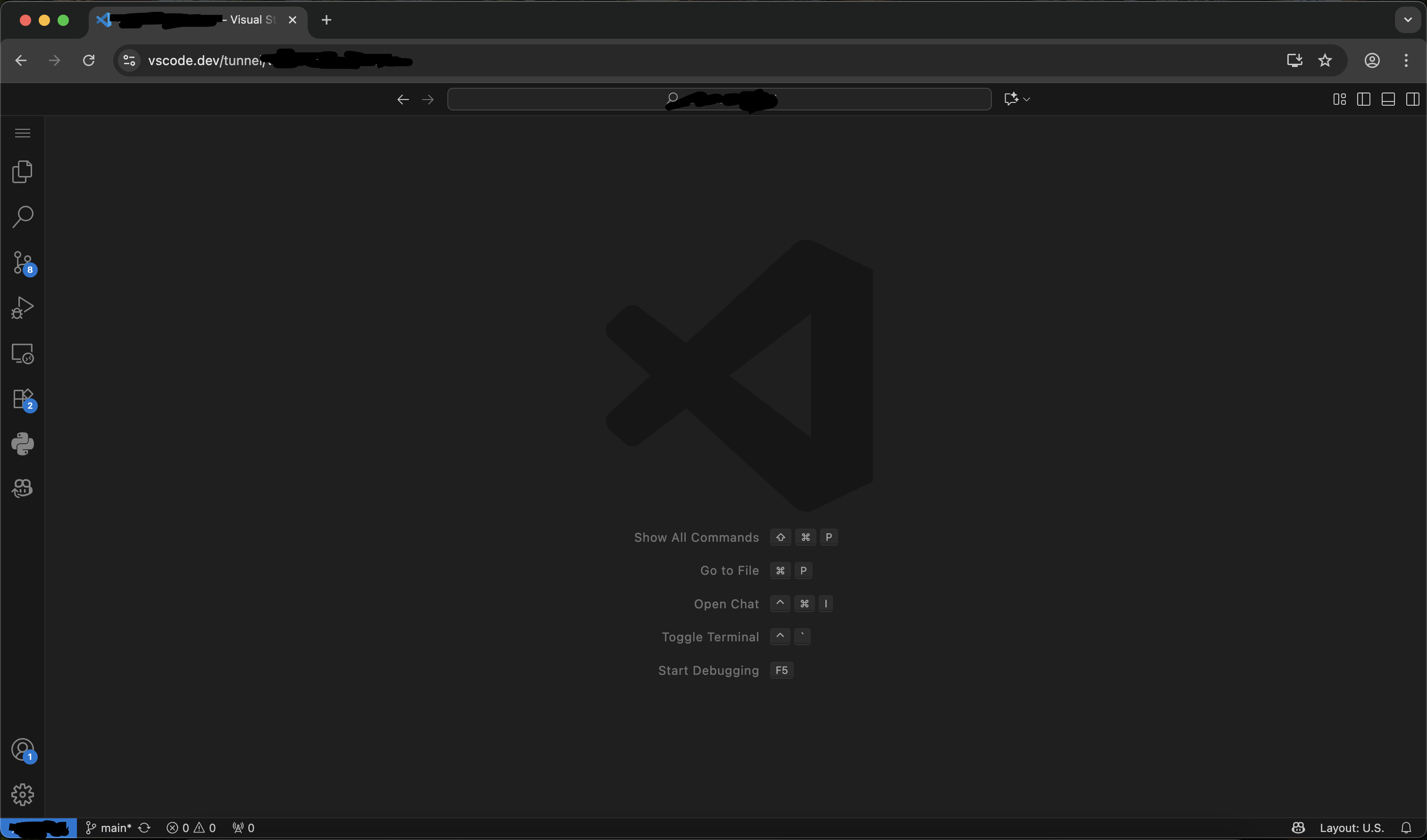

Why not use a tunnel?
You don’t even need a VPS, you can install this to get a ephemeral link that you can use to access your server from anywhere.
I personally use this to bypass corpo firewall.
I just tried it, works but you can only access terminal from within vscode right? My only problem with this is securty. If I’m gonna be saving my passwords on my server idk how safe this is

not just via vs code, you can also access it via web.
As for security, you sign in with your github, I have that protected with 2FA and a strong password - probably safer than most solutions out there.

It’s very convenient and easy to setup. I also used github with 2fa. Until I find a better alternative I’m gonna keep using this
